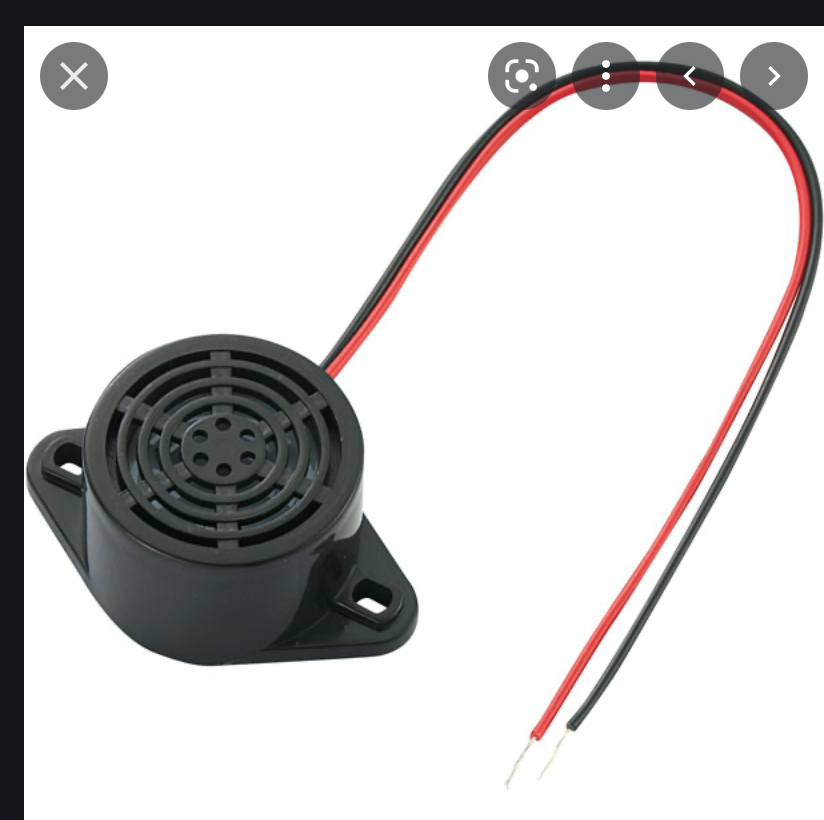

You did not say if the new buzzer is electro-mechanical or piezo. You did not say what is its very important voltage and current ratings.

A moment ago I saw the other forum about this rain detector and copied the photo of its piezo transducer that is not a buzzer and is not a piezo beeper that has an oscillator in it:

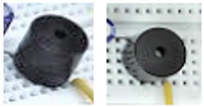

honestly i don't know how to connect it, I'm looking at circuits online put nothing concluant so far. I know how to connect it so that the buzzer buzzes but it always buzzes, not only when the there is rain on the sensor

the rain sensor works fine, salt or no salt. I honeslty dont know what type of buzzer it is :( there is nothing written on it and a friend bought it for me
As a test, connect the piezo beeping thing to a 9V battery with the red wire as positive and the black wire as negative. If it continuously beeps then it has an oscillator inside and is not the "transducer" that is needed.
The completely wrong circuit from India has a capacitor C4 in series with a wrong kind of speaker. If your beeper has an oscillator in it then it will not continuously beep if the capacitor is the correct way around but will beeeeep if the capacitor is backwards. The correct kind of piezo transducer does not need a capacitor C4 in series with it. The 555 is the oscillator that drives it.
when i only plug the buzzer, it beeps continuously, the thing is when i plug it in the timer with or without the capacitor, it doesn't beep. If i connect the timer as basic as it is with the buzzer, it beeps but its not beeping according to the rain detector
A piezo transducer is needed for the rain detector circuit. The 555 is the oscillator that makes it beep. A transducer makes only a click when connected to a 9V battery, not a beep.
Your piezo is a beeper that has an oscillator in it, your beeper is the wrong kind that is supposed to be a transducer.
Take a 9V battery to the store because a piezo beeper and a piezo transducer look the same.
The circuit might work with the correct piezo transducer and acid rain in India.
