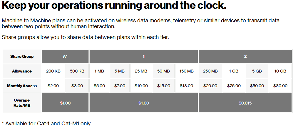

You don't need Internet, you only need WiFi - as long as you can get WiFi coverage where the pumps are this would be the far cheaper solution. Using GSM means call costs every time you use it, making it more expensive to use as well as more expensive to install.
I am not an expert. Last time they told me that "machine to machine" cell calls are billed very differently. I do not know what the means.
You can get special commercial SIM cards that are pre-paid, text only, and provide unlimited texts - I had one when I was designing and building a GSM based project for a friend's company. Unfortunately, it expired due to lack of use after the project was completed - you have to ensure they make regular calls or the card dies. I've no idea where you would get one, and this was one my friend managed to acquire through a third party, and couldn't get any more.
For a normal SIM a text is charged at the normal rate, regardless of what you use it in.
From Verizon: (US)
I don't understand data sharing but if I had one pump I would pay $2.00 a month and can keep the data to under 200k.
