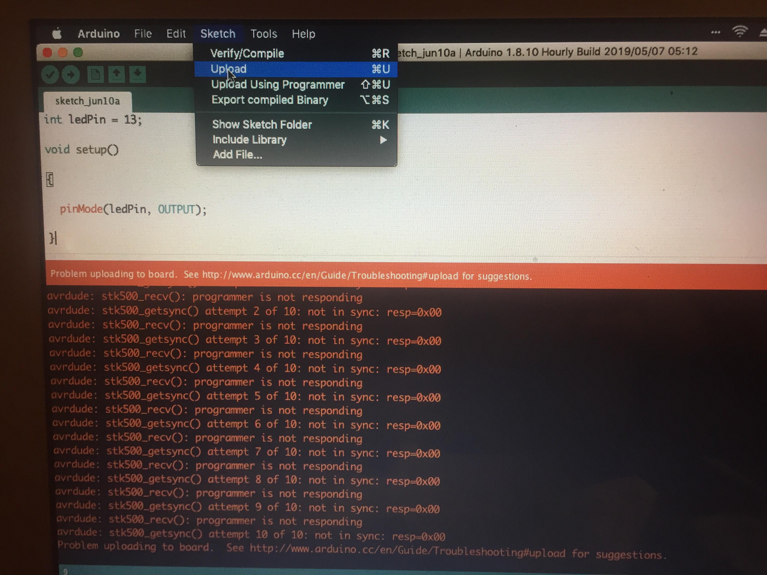

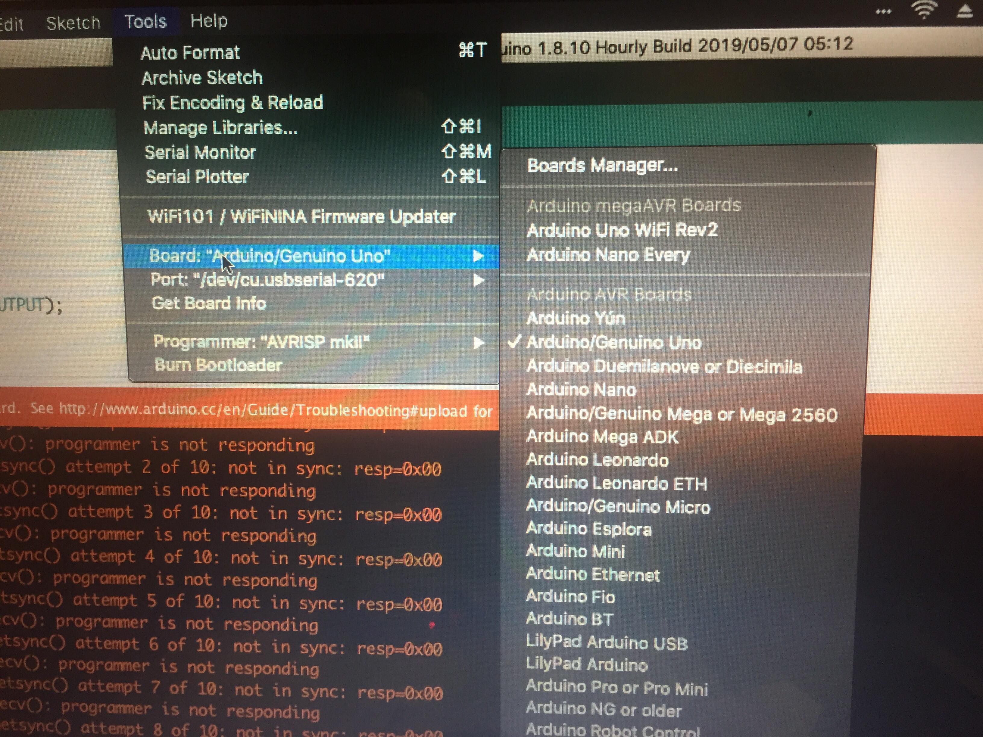

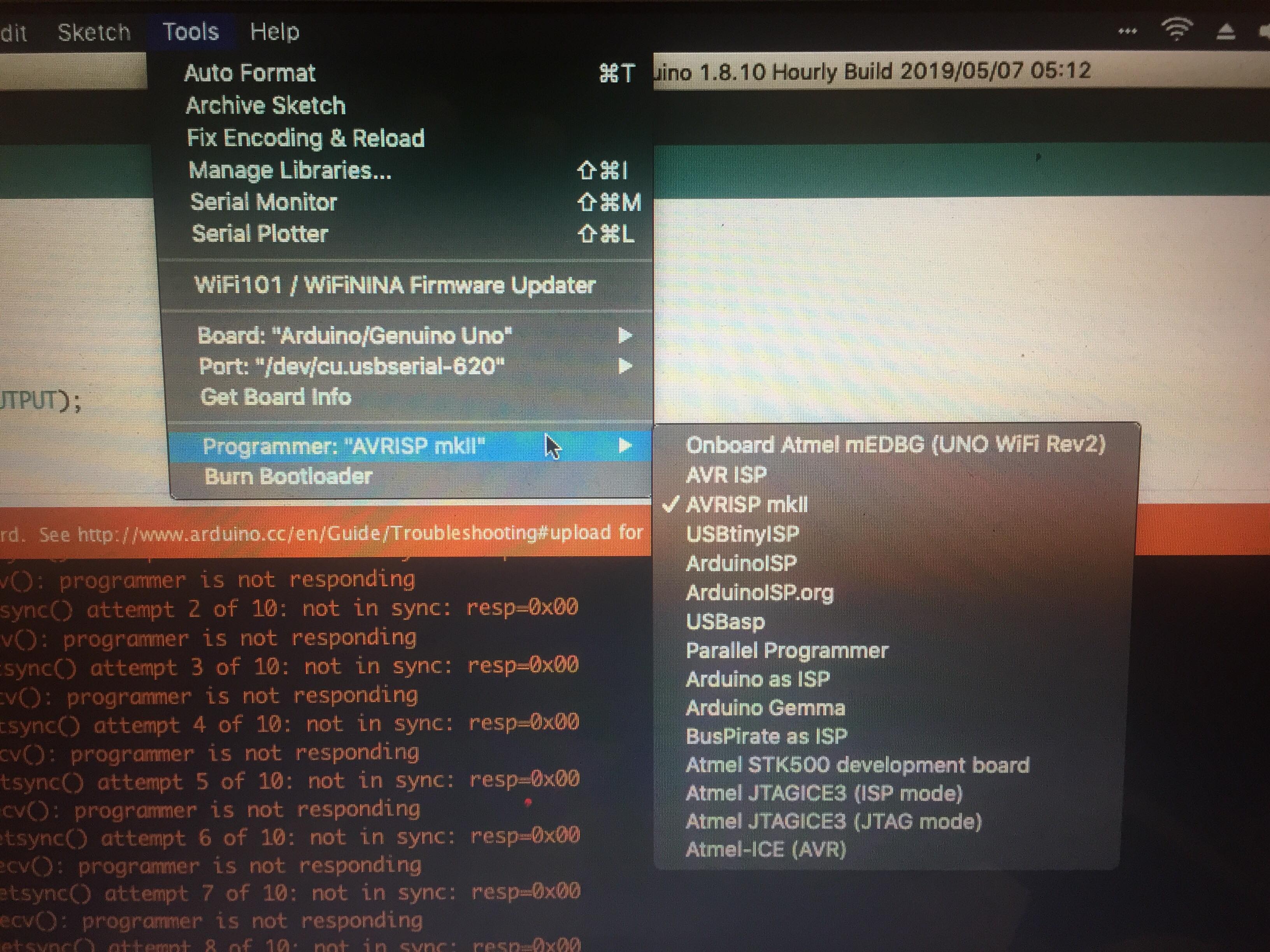

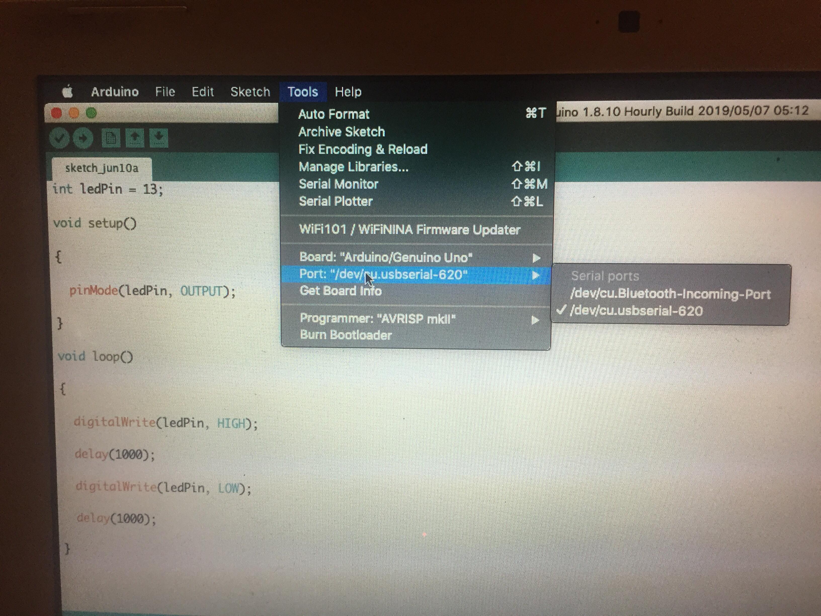

In the IDE you should be using "Sketch->Upload" - not "Sketch->Upload using programmer".
Also, what does it say next to port on the Tools menu?

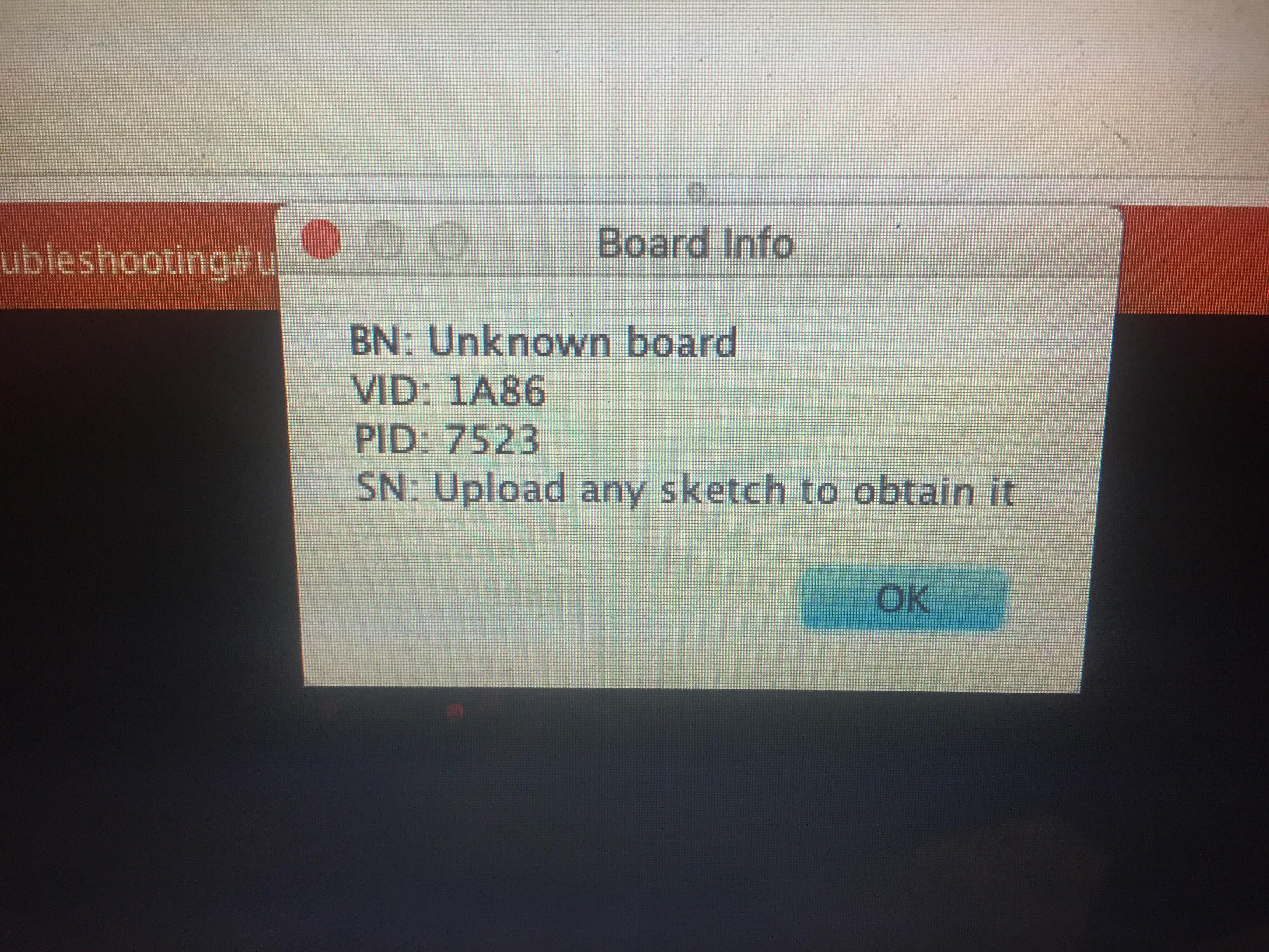

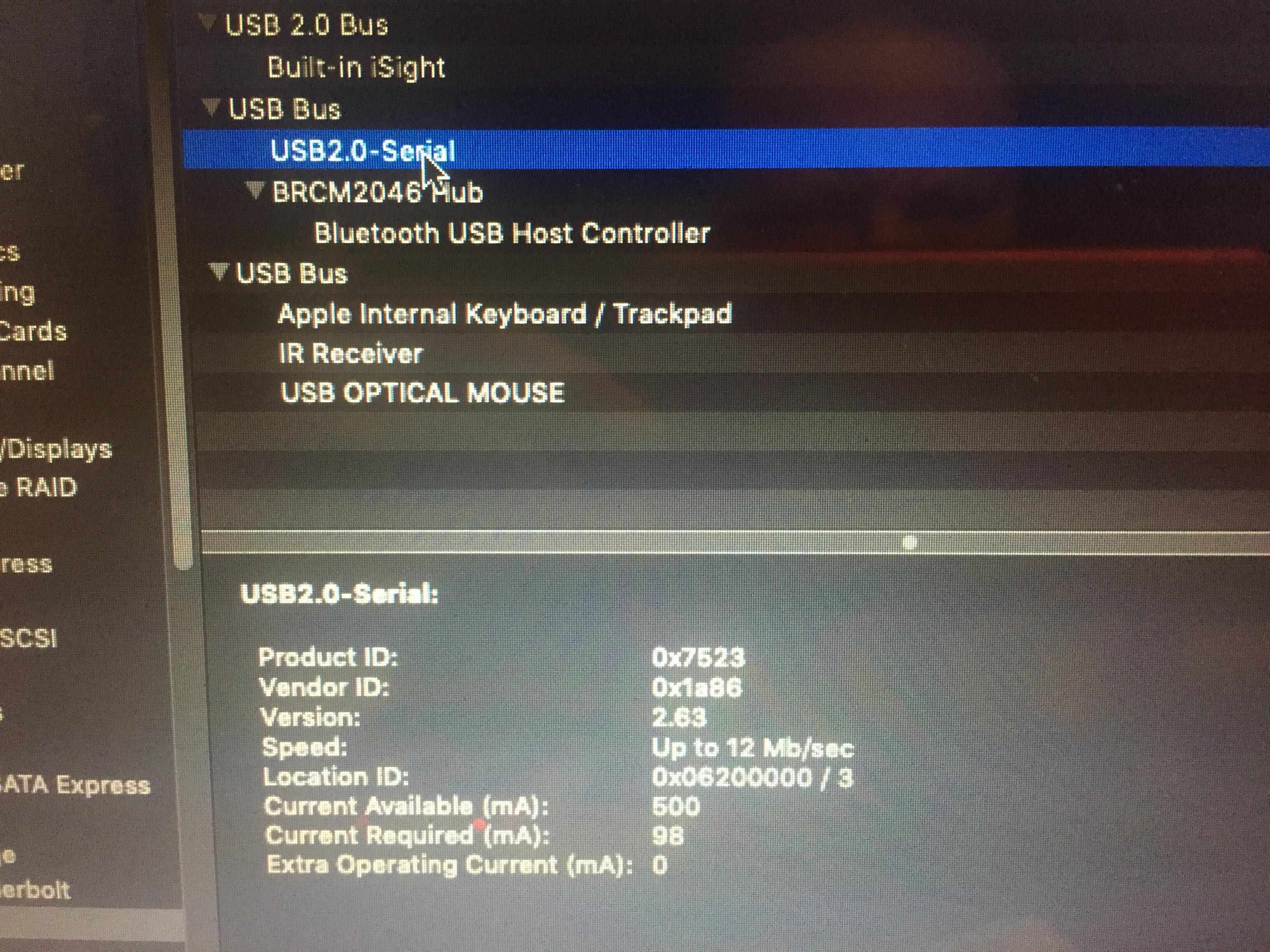

Edit, can you get a list of connected devices and see if the port exists?
Here is what i got

If you unplug the board does the serial port disappear? It may be that the driver for the CH340 chip isn't installed.
Sorry, I've always avoided apple due to them not playing nice with others, so I've no idea how to do anything. Maybe google "Getting stated with Arduino on a mac".

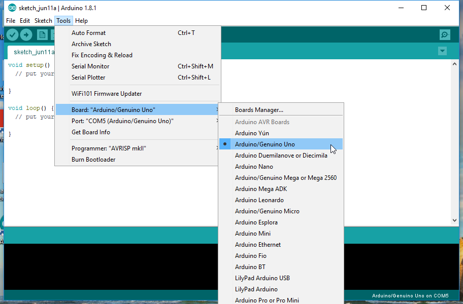

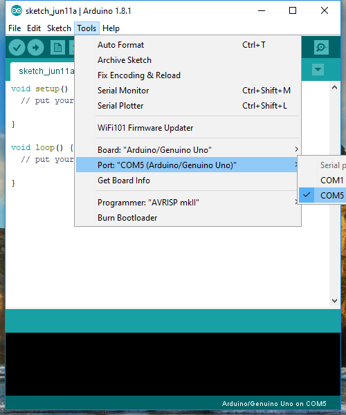

The most common cause of errors like you see is the software is not seeing the hardware. Here is what I suggest. Using the cable provided connect your Arduino to your PC USB port. Assuming Windows open your Device Manager. In the device manager window look at Ports (COM & LPT) you should see your connected Arduino along with a COM ? where ? is the port number.
Now open your Arduino IDE and click Tools and select your Genuino Uno board.
118799
Next setup your Com Port.
118800
Try what we have so far and when you copy and past the code sample make sure you clear whet is there when you click file new to paste the whole code sample.

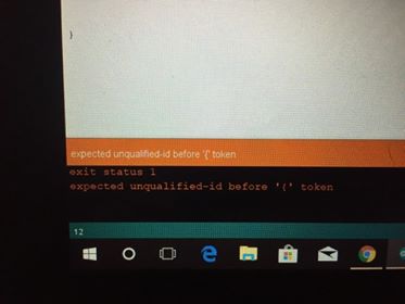

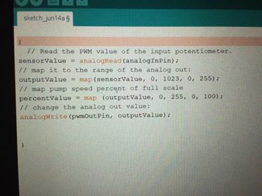

With the code you last gave me i got this error
Arduino: 1.8.9 (Windows 10), Board: "Arduino/Genuino Uno"
sketch_jun13b:1:1: error: expected unqualified-id before '{' token
exit status 1
This report would have more information with
"Show verbose output during compilation"
option enabled in File -> Preferences.
Ron's code needs to be placed in the main function,
#define analogInPin A0
#define pwmOutPin 2
uint16_t sensorValue,outputValue,percentValue;
    pinMode(pwmOutPin,OUTPUT);
    pinMode(analogInPin,INPUT);
void setup() {
void loop(){
  // Read the PWM value of the input potentiometer.
  sensorValue = analogRead(analogInPin);
  // map it to the range of the analog out:
  outputValue = map(sensorValue, 0, 1023, 0, 255);
  // map pump speed percent of full scale
  percentValue = map (outputValue, 0, 255, 0, 100);
  // change the analog out value:
  analogWrite(pwmOutPin, outputValue);
Note the above code expects a pot on A0 and the output will be on pin 2.
Edit added setting the pin modes.
