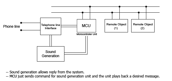

I'm starting a new project to remote a house via the phone line. I use ISD25120 to connect with operator. My question is that how can I playback the sound over the phone line?

I'm going to design a microcontroller based system. You can conect to a microcontroller via the phone and the system speaks.

ur problem is not clear to me :?
is it with connecting to the telephone line ?
if yes , it's simple.
-------C------
xge            audio i/p
lines
-------C------
C= 0.047u/400v
The telephone lines can have high voltage spikes , so make sure the above ckt is connected only after off-hook(use relays).
I think you can be presented with this diagram
