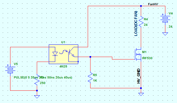

So my idea is to isolate the pic from the fan using an opto-isolator (4N32). I've done some work with optos in the past, but have forgotten much about it and the same goes with the MOSFET to drive the FAN.
Basically in the circuit below I'm having difficulty calculating (theoretically) what the output (Gate) to the MOSFET is going to be for a given CTR. I've always been confused with this and want to be able to get over with it. Next what voltage do I need to drive the gate of the mosfet, I know this depends on the drain current, but like on the opto-isolator I've forgotten how to do all the math. Some input or directions will be appreciated. I'm using R4 to simulate the fan, I don't have a protection diode because the Fan has internal protection already.

The FET will be turned full on with 10 volts or so on the gate, but 24 is to much - the gate to source maximum is 20 volts for your fet. So You can add another 1K resistor between the collector of the opto and the +24 then you should be ok.

The motor is probably inductive so you will want a diode across the motor, pointing up, so no current flows through the diode. The diode will help protect the FET.

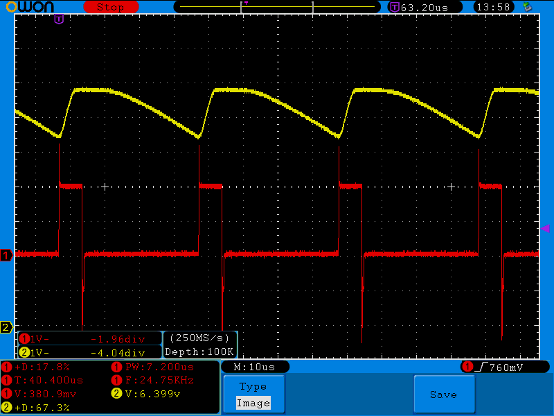

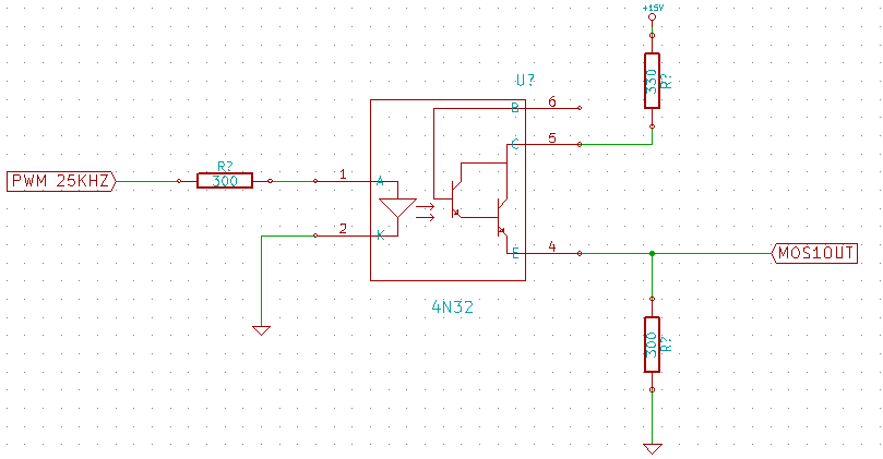

So I got to do some more testing. Below are my Images and current circuit setup. The issue now is that my PWM input doesn't translate equaly to my output, my input is ch1 with probe at pin1 and output at MOS1OUT ch2. I want to keep the voltage output at MOS1OUT at about 7-8V for the gate of the IRF511, which should be goog enough to drive the Fan at 1A. I don't have a 24V supply available yet, so I'm using a 15V supply for the moment and testing. Is there something I'm missing here?

I'm not sure I know where ground is for the traces and what the volts per division are, but I think you may be running it to fast for the opto. The turn of time can be 100 usec. or so.
Im doing 25khz. The input ground traces are from the 3V regulator and the output trace from the 15V power supply, so the grounds are not from same source. I alsi noticed that if I lower my frequency to about 60Hz then the input pwm and output are much more identical.
Yes 25KHz is to fast for the opto, but it should work pretty good at 2500Hz.
ok so, I got it working now @ 1.35Khz. I used a 100K resistor to ground the base, which helps make the output waveform almost identical to the input. The only thing now is that the MOSFET (IRF530) is getting pretty hot. Specially at lower duty cycles. What's causing this? How can I calculate the power going through the MOSFET? Will lowering the frequency make it run cooler?

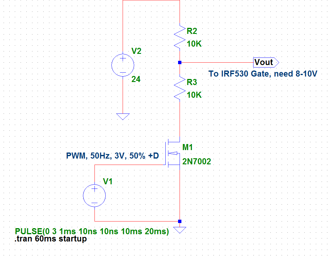

Don't forget you may need a logic level FET or a little transistor driver to run directly from the 5 volt micro.
So I got the below circuit to try to bypass the opto-coupler, but I'm not getting the right output (or what I expected) to the gate of the IRF530, which I need 8-10V. The micro-controller output is 3V at 50Hz to the gate of the 2N7002 and my 24V supply on the drain side I want to bring down to 8-10V. Any Ideas?
