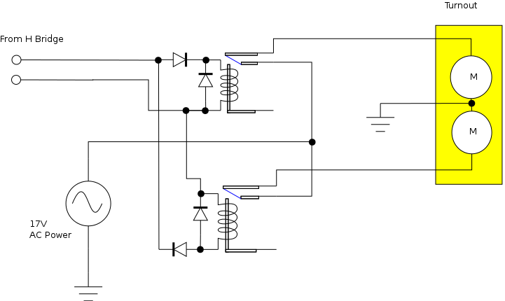

It looks as though your switch machines have 1 wire to push out, one wire to retract, and a common. They might work using DC, you'll just have to try it - just stick with the same wiring scheme - the voltage probably won't be the same as for AC though. Depends what they are using to drive the pushy-pulley bit. It would be better though to use relays or opto-isolators. It shouldn't be hard to arrange that the polarity of your controlling signal switches 1 relay/isolator or the other. In fact, with opto isolators, if the LED has a high enough reverse voltage, you won't need any extra components, just connect a pair with opposite polarity inputs to each pair of control wires.
Hope I've understood your question correctly and not just written a load of rubbish!
The switch control box has an AC input, but may have DC outputs. Can you check with a multimeter?

This (attached) is what I was trying to say. The two "M" symbols in the turnout represent some kind of motor/servo assumed to be inside. You could probably modify your H bridge to to the job without the extra relays (which in theory could be opto isolators)

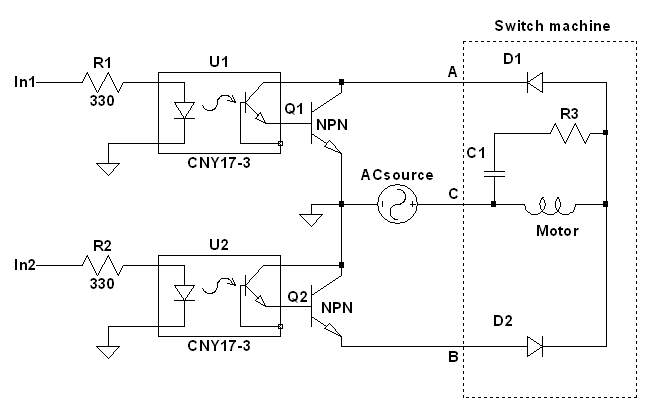

Here's how you could do it with solid state components. Your H-bridge (or two output pins of the Arduino) would connect to In1 and In2. The opto-isolators prevent any switching spikes from getting back to the Arduino.
I have assumed that the AC switch machine is similar internally to the DZ-1000 and simplified it for simulation purposes.
