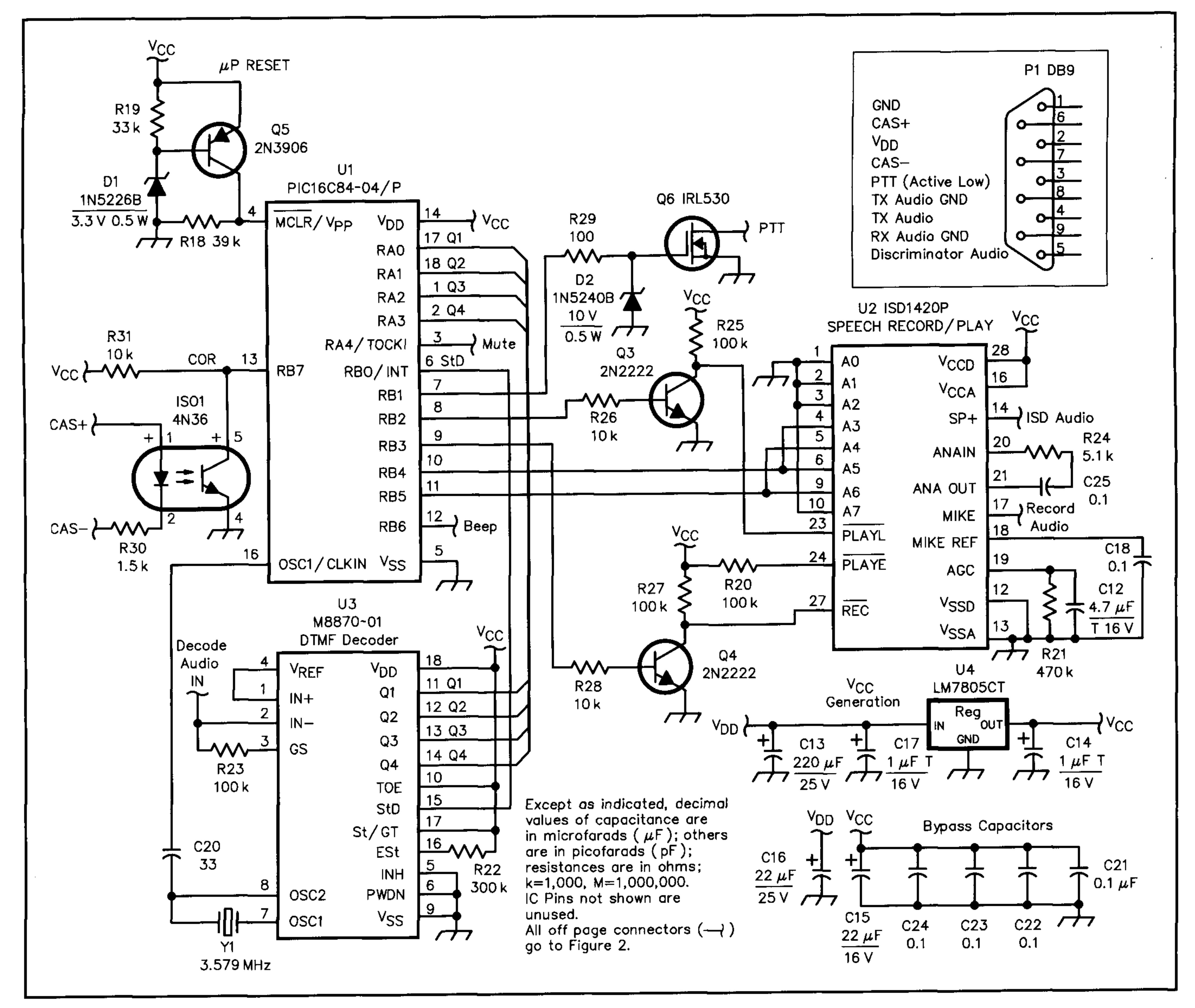

eu tenho o programa 16c84 e quero converter este programa 16f628a preciso de ajuda para fazer isso.

Hello Mr. Nigel good afternoon, I would like to thank you for your kindness in helping and answering my question, my programming knowledge is weak, I am an Amateur Radio in Brazil and I would like to make this program work for our local VHF repeater. I made some changes and put several ***** (asterisks) in the lines I changed, but I don't know if they are correct.
Thanks again Jason - PP5MEL

I had a quick look at your file and the only thing that stands out is the interrupt must be at location 4 - you've changed it to 0x100 (actually, might be 100 decimal). And, w_copy needs to be in common SFR area (0x70+), also, the push macro isn't clearing RP0 - it may be in bank 1 when it enters the interrupt.

You put the CMCON in the wrong place... This forces relocatable code..
You need to place it directly after the "start" label
start
        banksel CMCON
        movlw    0x07        ;************ADICIONADO turn off comparators
        movwf    CMCON       ; ***********ADICIONADO
This file will compile to the 16F628A.
There are only 2 changes needed to the original file besides setting the 16F628A inc and processor and I have marked them with ;----------------------------------

The bcf STATUS,RP0 needs to be moved to after STATUS is saved or it'll always return in bank 0. Also, w_copy (and s_copy) needs to be in the common area in case it's in bank 1 when the ISR happens, actually, it'll still work as the bank is restored before w_copy so it'll just be saved in whatever bank it happens to be in - this wasn't needed on the 84 as all memory was common.
Actually, it won't work as STATUS will always be restored from bank 0.

I used the 16F628 datasheet example (I know, probably a mistake).

Caro boa noite, obrigado mais uma vez, compilei via Mplab, compilei mas não faz as ações na placa, preciso alterar algo nos fusíveis? Estou bem perdido.

The repeater controller is from QST magazine February 1997.
If the original software worked, there isn't anything different in the updated file that would stop it working that I can think of but I will double check the Config word to make sure.
I've updated the file with a new Config setting just in case the MCLR setting was causing a problem (it should default to ON).

I haven't looked at the code, but the General Purpose Registers (user program variables) start at 0x0C on the 16F84 and start at 0x20 on the 16F628A. Has that be fixed, if necessary?
Yep it was XT - updated the file in post #15
File still reads _XT_OSC. Shouldn't it be _EC_OSC not _XT_OSC? I.E. I/O on OSC2 (RA6) and clock in on OSC1 (RA7) as per the schematic above. I've never used an external clock so not sure about this. What is in the original file? Just checked, the 84 didn't have the EC option so not sure how this will work.
The OP's original file was XT and the file from the QST file library (original original) is XT (I had put HS in the file), maybe the 16F628 doesn't like being fed an external signal whil;e in XT mode..
Jaison, replace the Config file in rtp2022_628_2.asm with this one if it still doesn't work as per Pommie's suggestion and see if that makes a difference.
__config _CP_OFF&_LVP_OFF&_BODEN_OFF&_MCLRE_ON&_PWRTE_ON&_WDT_OFF&_EXTCLK_OSC
