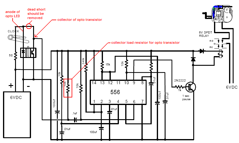

I added the changes you suggested into this circuit. I hope I have the pinouts shown correctly (I used a circuit with two 555's). I received the opto sensors today, so i'm going to incorporate everything unto one breadboard and see how that works out.
thank you for your help
A quick glance showed the collector of the opto transistor shorted to the anode of the LED in the opto.
Pin 8 of the 556 is the trigger input of the second timer. It won't work without a resistor to the positive supply.
Pin 10 is the reset pin of the second timer. it might be intermittent without a resistor to the positive suppply then a capacitor to ground will provide power-on-reset like at pin 4 for ther first timer.

I made the changes you suggested. You mentioned about the short circuit
from the collector of the transistor to the anode of the led(in the opto). I'm not sure what you mean by that. I have attached Vishay specs on the opto and on page 3 it shows a test circuit. It didn't show +5v to the led and that confused me.
I explained what is shorted to what.
Here are arrows in your schematic:

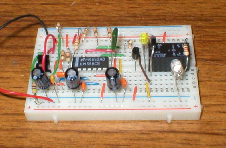

I have the circuit breadboarded. When I first turn it on, I get a the relay on briefly then the 556 times out and turns on the relay. I can't get it time again until I shut it down and turn it back on. I tried taking pin 6 to ground but nothing. Any ideas?
The value of the capacitors on the reset pins are very low at only 0.01uF. Try 0.1uF.
When pin 6 is grounded for a moment then the timers should work again.
it works better with .1uf caps but it's not triggering from the opto.
I'm only getting .08 volts from collector of opto to ground. I tested the opto with an led and it works fine.
When the opto is turned off, its collector should be at the supply voltage. When it is turned on, its collector voltage should be 1V at the most.
