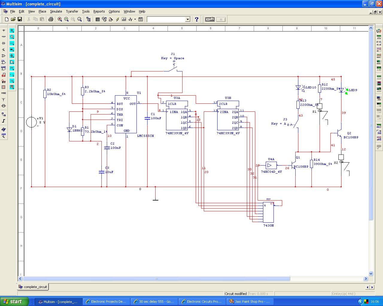

Ok guys can any help further please. I now think I have a counter circuit, but im still having problems big time.
The 555 is astable and counts 30seconds through the dual 4-bit counter.
Basically I then need the output to turn the transistor on, and turn on S2 (this is gonna be a reed switch which is not in the design package so just used a switch) S1 again is a reed switch which latches S2 until the reset switch is de-pressed.
problems i have is cause i need a 30 count, delayed i could not use monostable. But using astable the counter is always on. I will have an input from an optocoupler which i want to trigger the counter device.
Also I have no idea how to connect the reset to the counters.
Am i barkin up the wrong tree with this whole design. ?
Also my output to the transistor is only a 1 sec pulse, does this matter to turn it on to turn on the reed switches
Once the reed switches are latched id doesnot make any difference to what the circuit is doing, unless there is another signal from the optocoupler.
Please help I have lost the will to live at the moment
I have attached the print screen too
The dual timer is a 74393, then outputs go to a 8input nand, through a invertor to the transistor bp108.

I would suggest that you place the J2 reed sw in the collector circuit of Q2, in series with LED9, connect the emitter to 0V.
Which is the RESET button?
Why didnt you choose a 555 pulse rate that gives an high output U3B/8 at a 30sec interval, it would remove the gate driving the opto.
A 1sec pulse more than enough to operate a reed sw.
Is the opto shown with all its connections?
I cannot see any decoupling capacitors on the circuit?
If I am reading your schematics correctly, there is a wiring error in your 555. Pin 6 should be connected directly to pin two so it can discharge through R2. This will improve your timing output.
There are to reset switches in the circuit.
1. is clear the counter prior to the count comenceing
2. the reset for the latched reed switch, which holds the other reed switch on
Sorry but I really think you are. I would start over again with a different idea.
There are easier ways to get a 30m second delay.
I will post up circuit diagram tomorrow, when I get a chance, however here is a brief explanation.
The problem with the reset/clr for the binary counters.
As I have an opto isolater as my interface, the reset have been held high unless i get input from the device this circuit is for. Ie a low. As the 555 is astable and constantly running, the counters are released and counting comences.
With requards the transistor etc.
The output from the counter goes into a binary latch/flipflop. Once the count reaches 30, the 1 sec pulse, turns Q to a high. This turns on my 4 coil relays and as the enable on the flipflop is held by a further n/c coil relay, the the other 4 relays are now latched. There is a pushbutton switch on the enable pin to reset the flip/flop, which in turn resets the 4 coil relays.
I hope I have explained it well enough. Like I said I will post a diagram tomorrow.. And again thanks for all your help guys
