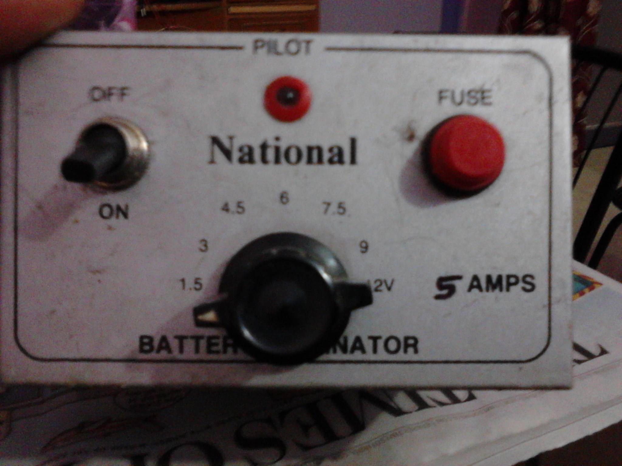

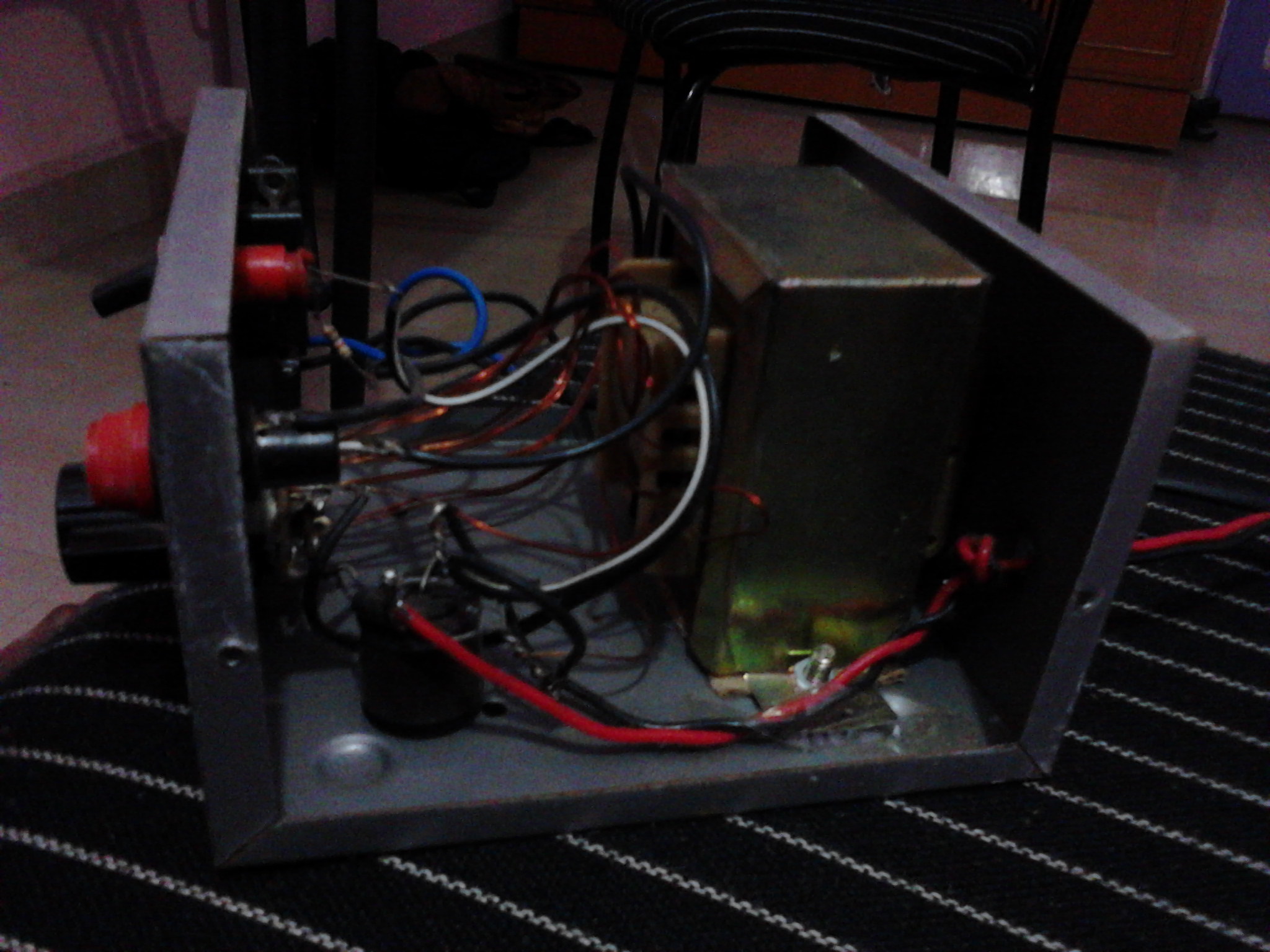

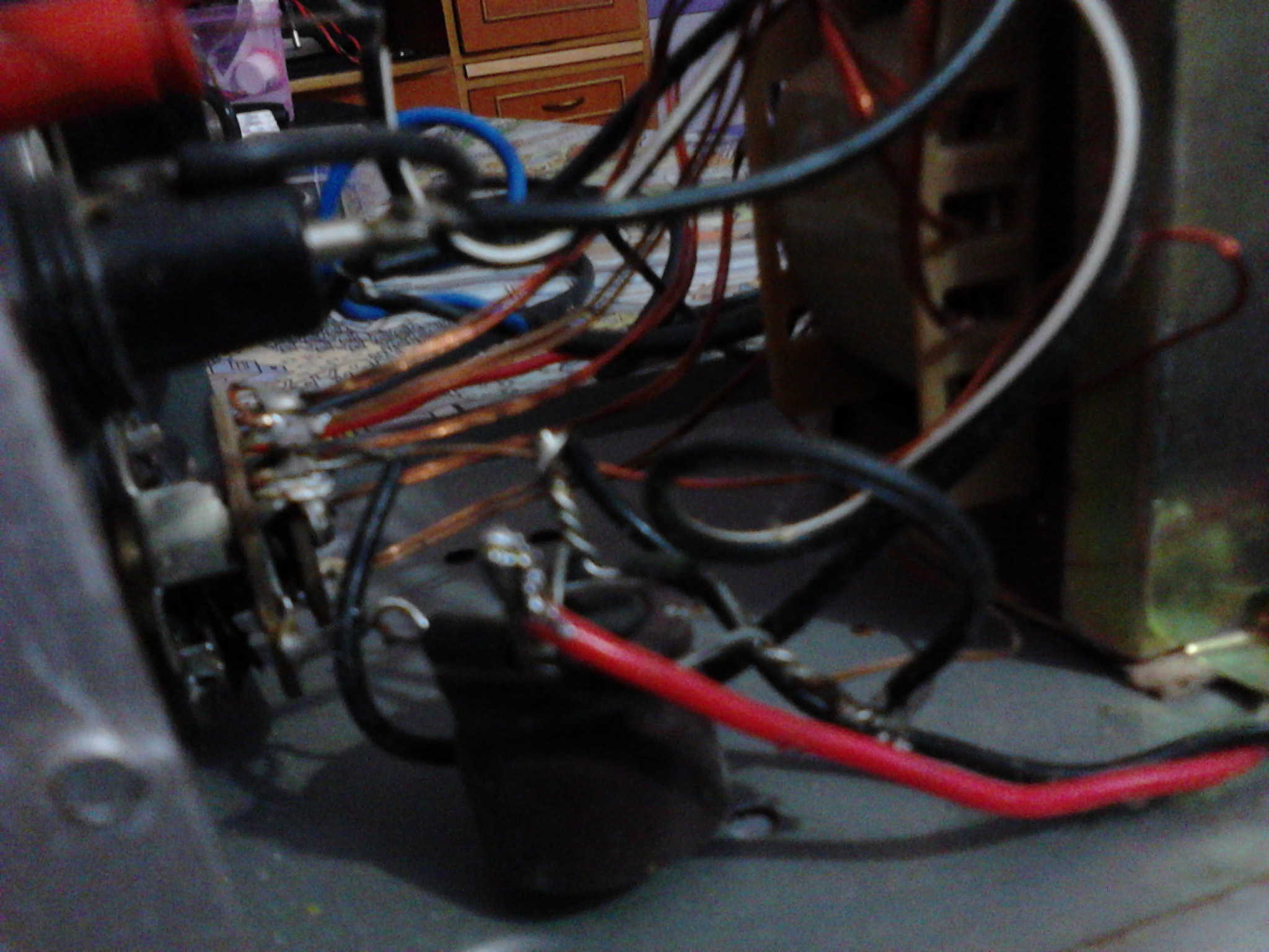

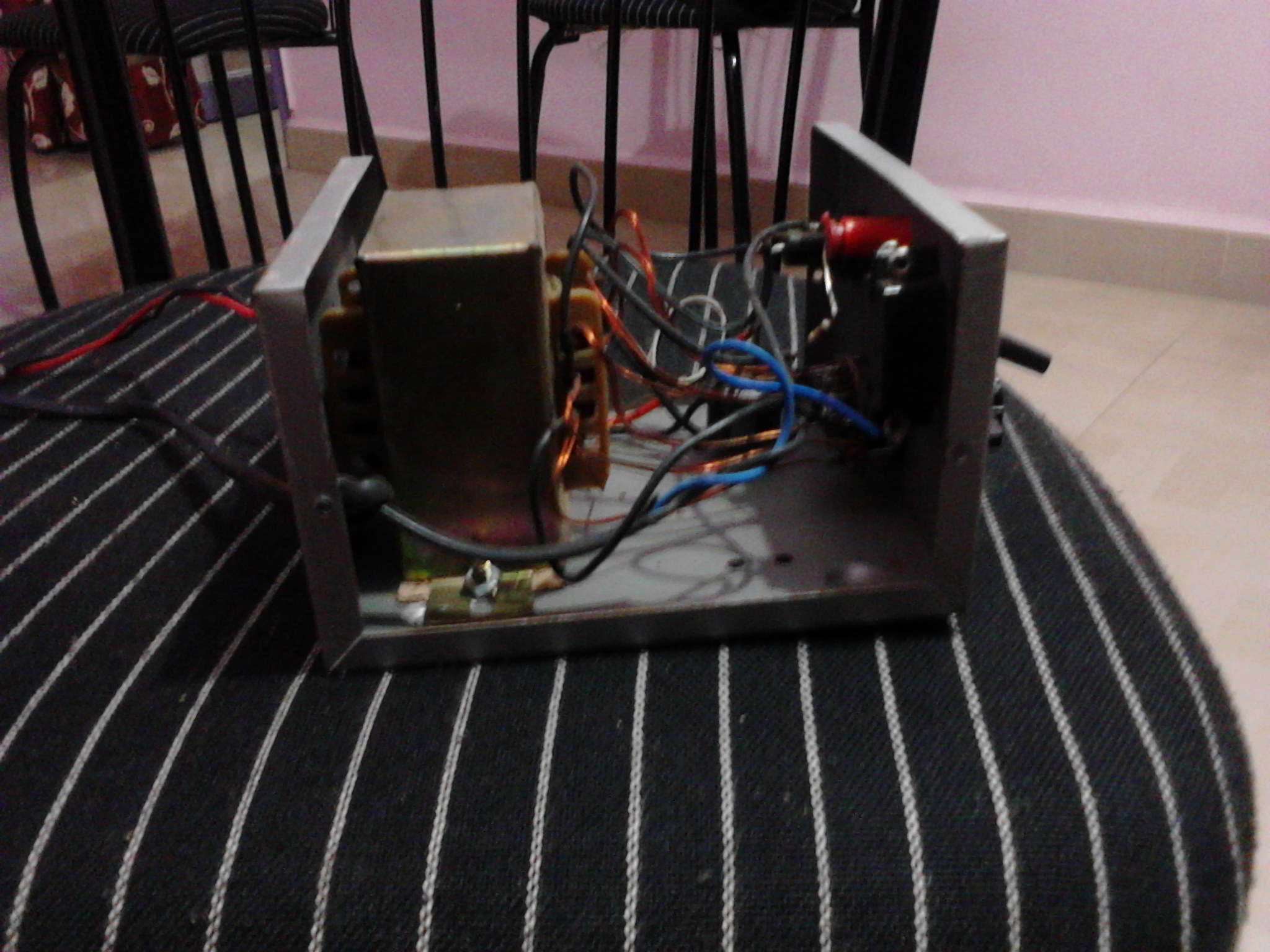

here is how my old power supply looks like
attached img: mobile uploads so might lack bit of clarity

It looks like you have a transformer with multiple taps on the secondary, which is a very valuable starting point for a regulated test bench supply. It is very useful to be able to select a tap to control the unregulated voltage upstream of an IC regulator. This will keep the power dissipation in the IC regulator to a more reasonable level compared to always starting with an unregulated voltage of ~35V. The tap should be selected so that at the min point in the ripple across the filter capacitor, the voltage into the IC regulator is just above the supply output voltage + the dropout voltage of the IC regulator (typically ~2.2V). The downside of this arrangement is that to set the supply to some specific output voltage, you will have to manipulate two knobs, rather than one.

That power supply in the given image
for your kind info is not at all and in any way connected to a IC or transistor
only to a pot, a bridge rectifier(4 diodes and a cap), then taken out directly
there is a link in one of my above posts which shows a ckt. diag and schematic i am currently trying to follow that design .
also image 1 will give you approx. idea about the available voltages.
That is the one misbehaving powersupply i talked about earlier(wires are intact).
