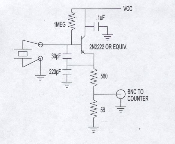

Parallel resonant crystals always have a shunt capacitance specified that will put it at the specified frequency
I am not very sure what you mean by this russ. I found a model of a RLC model of a crystal. Could you draw it in?

This is a crystal oscillator, it is a Colpitts circuit. The 30 pF and 220 pF caps are in parallel with the crystal. The capacitance is probably a little more than the specified amount, but it is close in most cases.

I forgot to upload the crystal model that i found (its not the first time), but from what you said russ, it is just capacitance used to change the frequency a little bit?
