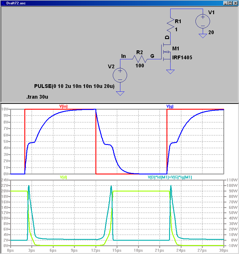

I know the general formula to charge / discharge Mosfet's is: Qg (Total gate charge) / t (desired switching time). My question is what should my desired switching time be?
If for example, the rise / fall times of my mosfet are 25 nS , but I have a 20 kHZ PWM input to the gate of the mosfet's, should my desired switching time be 25 nS or 1/20,000 ? Or somewhere in between? Exactly how in between and why? How fast would you want to switch in this situation.
Thanks.
Do some simulation.
You question is how fast is fast enough. As the FET drain switches from high to low or the other way, it passes through a region where there is drain current, and the drain voltage is near the middle of its range. That is where the device dissipates serious power. The goal is to get it to move through that range as fast as possible, and as infrequently as practical.
Look at the very simple attached sim. The light blue trace in the bottom pane is the Fet's enemy; dissipation. Note how the gate capacitance and Miller capacitance slow V(g) due to the 100Ω source resistance.
LTSpice or other similar simulator will let you explore the envelope.

I'm just still a little confused whether the time part is referring to the given transistor switching parameters (rise and fall times) or your actual PWM switching frequency?
It's both.
The slower the rise and fall times the higher the power dissipation and the higher the frequency the higher the power dissipation. At low frequencies, the rise/fall time is less important because it's switching less often but at high frequencies the rise/fall time is very important.
