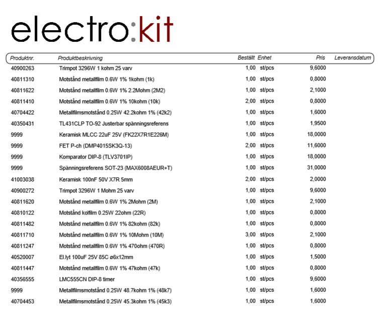

I sent an email to my local shop and they put together this list from my mouser list.
(there are some other components there for another project, the timer, a capacitor and a couple of resistors)
Hope all parts are ok? And that all the ordering hazzle I created is worth it :)

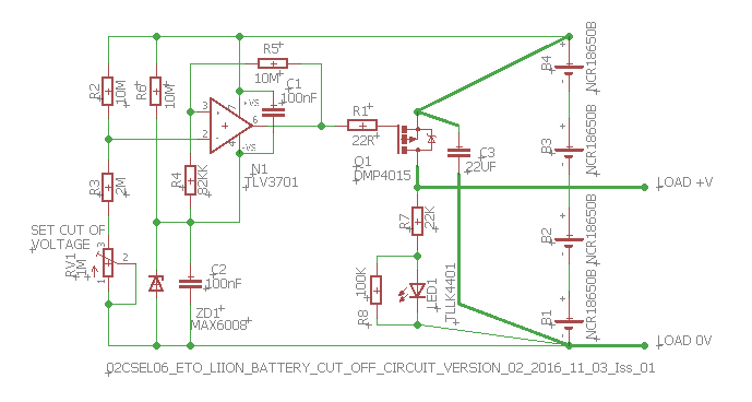

Hy Jeff,
Yes, we have designed for two different requirements. I must down load LTSPICE some time and learn how to use it.
The OP is planning on building both circuits so it will be interesting to see how they turn out.
Thanks for your info too- as i have said many times before, I always learn something new from other designers. :)

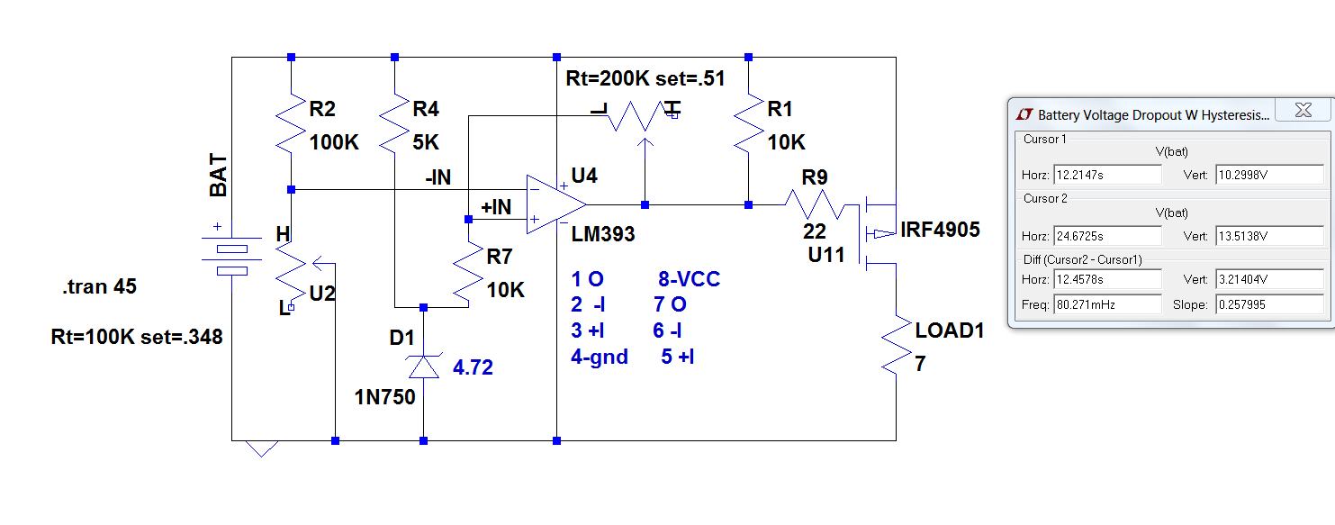

I used spice to find the set point on this attachment using 'zero in' via trial & error, I find it to be an invaluable tool.
Me too, here's what I built, I'll add actual test voltages & a photo shortly

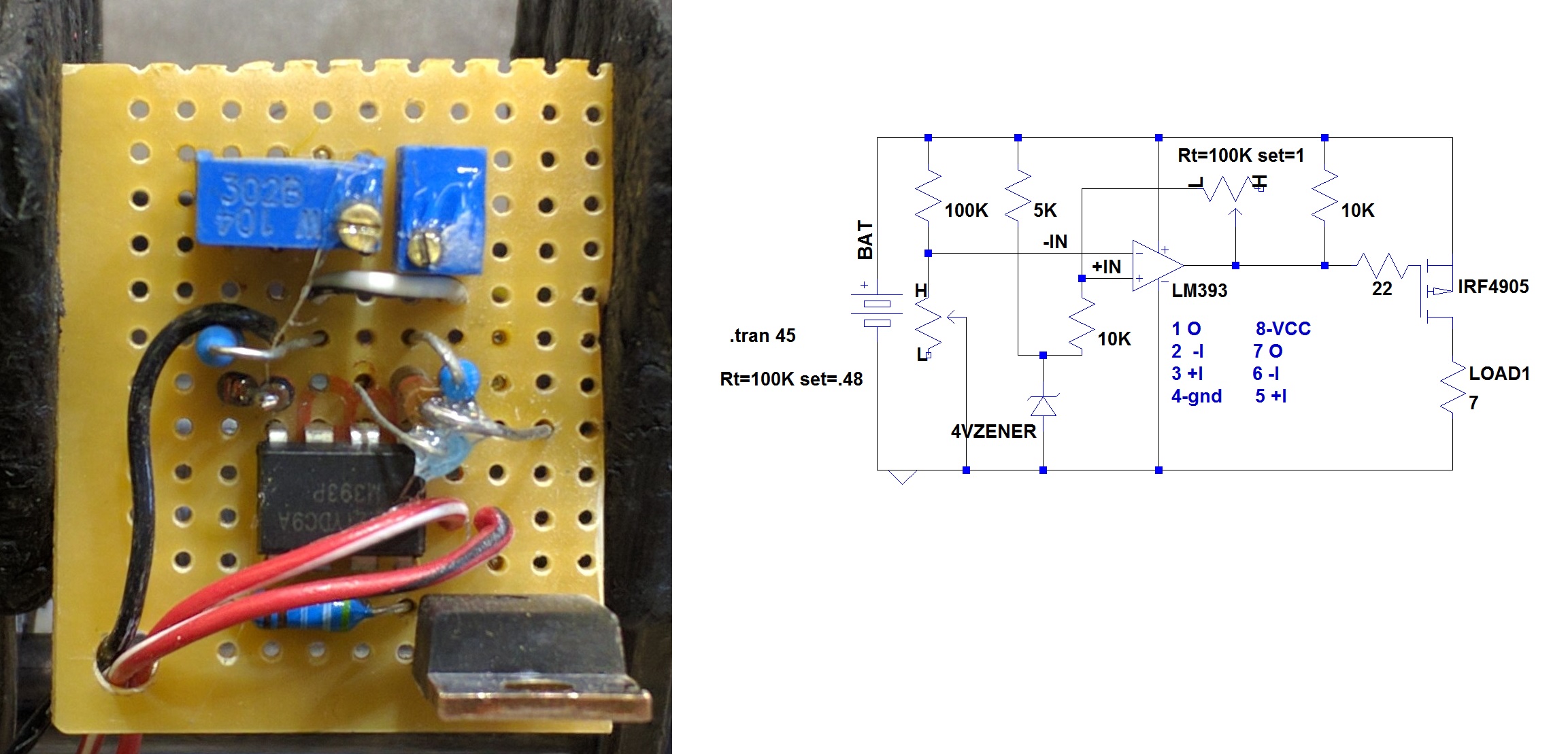

View attachment 99454View attachment 99471
Looks good too- very neat. Suggest putting a 100nf ceramic capacitor across the supply pins of the comparator.
It would be much easier to calculate the set point and hysteresis rather than using SPICE. It is dead easy.

No sweat Rorut.
LED indicator will be possible- will sort out.
spec

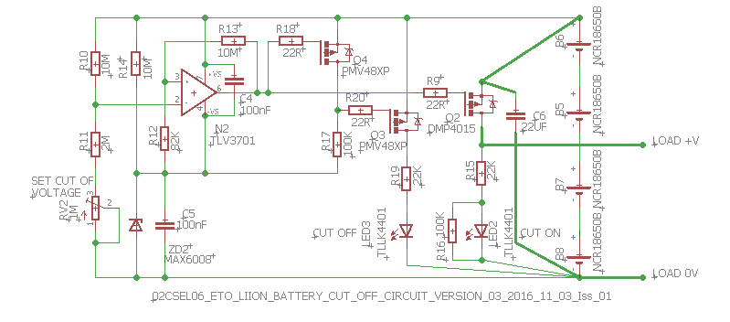

Hy Rorut,
Here is the latest cut of circuit fitted with a red LED which illuminates when the battery stack voltage is above the cutoff voltage. Instead of the LED coming on when the the circuit cuts off I have implemented the reverse which is simpler to do and arguably better because it drains a low battery stack less. If that does not suit you, let me know and I will work out the opposite sense. You could also change the LED color, although a red LED will be the brightest for a given current.
The LED forward current is set to around 470uA which means that the circuit, when switched on, will now take 470uA rather than 3uA. When the circuit turns off the current will still be 4uA though. If the LED is not bright enough lower the value of R7: 10K will increase the LED current to 990uA, which should be fairly bright. 4K7 will correspond to 2.1mA which will be very bright. You could also experiment with lowering the LED current by increasing the value of R7. The formula for deriving the LED current is 9.9V/R7.
R8 prevents the LED from illuminating slightly due to any PMOSFET drain source leakage current.
Note that the eye's response to light is logarithmic, so the perceived LED light intensity will not vary as much as you might imagine. The LED current versus light output is also non linear.

Hy again Rorut,
Here is the cutoff circuit with both cuton and cutoff indicators- you chose.
spec
NOTES
(1) R15 and R19 define the current through the LEDs according to the formula I = 10.4/R. Where I is in mA and R is in K Ohms
