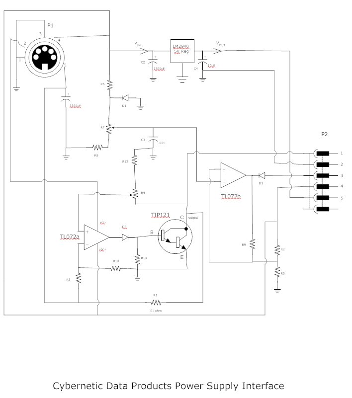

I recently came across a couple of old LED signs made back around 1990 by Cybernetic Data Products. These went by the name "Silent Radio." Unfortunately, the ones I have did not come with the power supply module. I think earlier models had the complete power supply built in and you just plugged in a standard AC cord to power it up, but mine have a 5 pin DIN connector on the back instead. I took the circuit boards out of the case and found that 5 pin DIN connector mounted on a circuit board that appears to be the power interface for the rest of the sign.
I made a schematic drawing of this board in order to figure out what voltages are needed at the 5 pin DIN connector in order to bring the sign to life.
I'm pretty sure the drawing is accurate, but I'm not understanding all that I am seeing there.
So - in the upper left of the drawing is P1, the 5 pin DIN where power comes in. On the right is a 5 pin connector that connects to the remainder of the LED sign. The TL072 op amp specs say that VCC is normally +/- 15 volts, so looks like pin 2 on P1 should be -15 volts and pin 4 of P1 should be +15 volts.
Pin 4 of P1 also connects to the input of a 5 volt voltage regulator, so that 5 volt output appears on pin 5 of P2. Pin 1 and 3 of P1 are ground, so that just leaves pin 5 to figure out. I don't really see what is going on with the two op amps and the TIP121 power transistor. Can someone help me figure this out so I can build an appropriate power supply to feed P1 please? Many thanks in advance!
