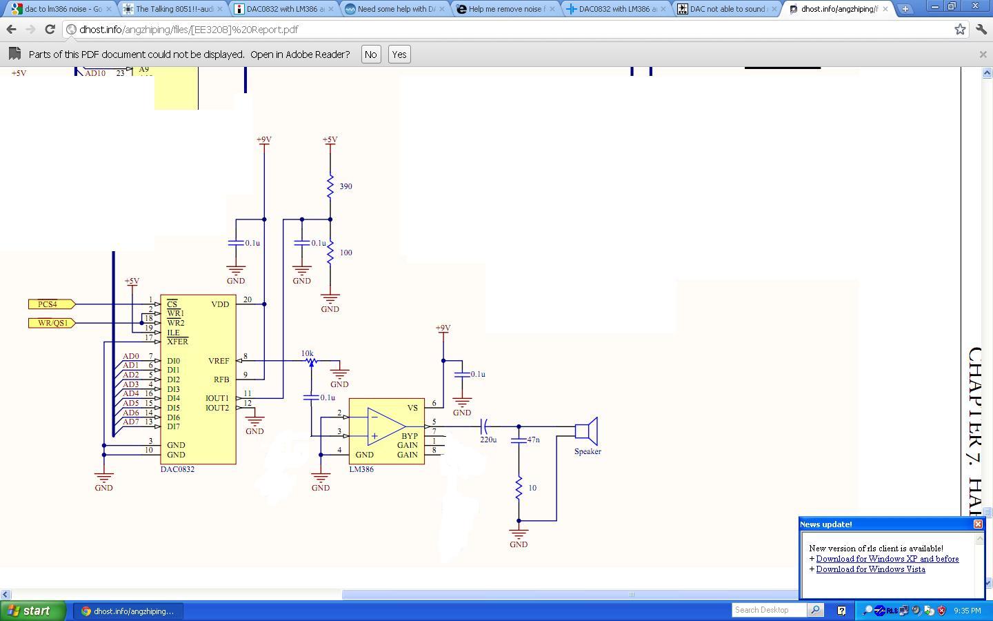

Hi all, gundu is my groupmate. Btw we found out from other group that actually this schematic works (DAC from datasheet.pdf). May i know what is the difference between the schematic found in datasheet and ours(DACv1.pdf)?
*there are 2 wire we have made amendment marked out with annotations in our schematic(DACv1).

Tnecniv,
What are you doing?
You wrongly disconnected pin 2 and pin 4 of the LM386 power amplifier from ground and connected them to pin 5 instead so the LM386 WILL NOT WORK!

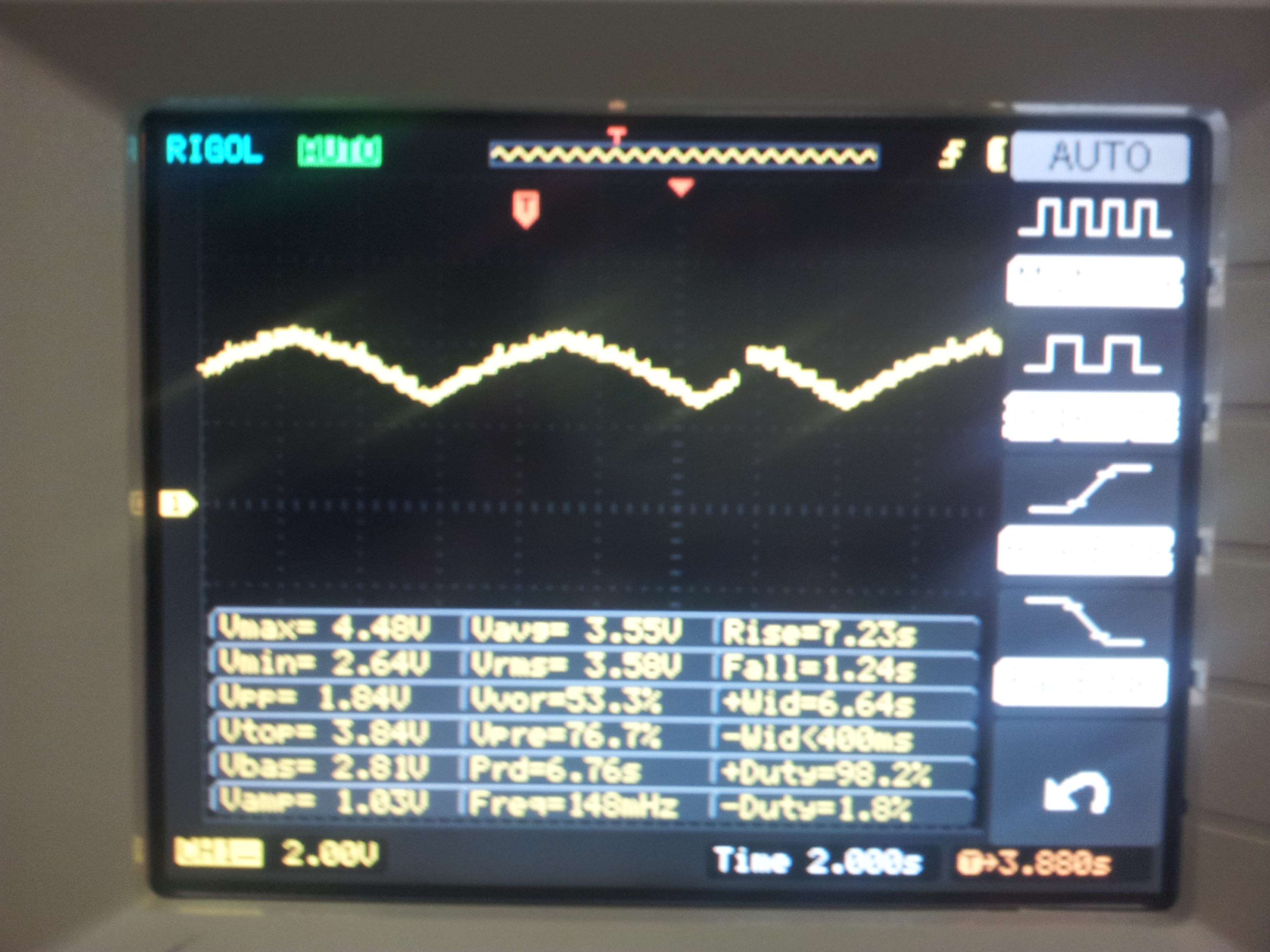

This is the signal measured from the oscilloscope for the circuit, this is measured from our DAC directly without going thru the amplifier. we have included a voltage divider which include resistor 1k ohm and 10k ohm to the DAC Vref input making it equal to 0.5V.(sawtoothv1friday.jpg)

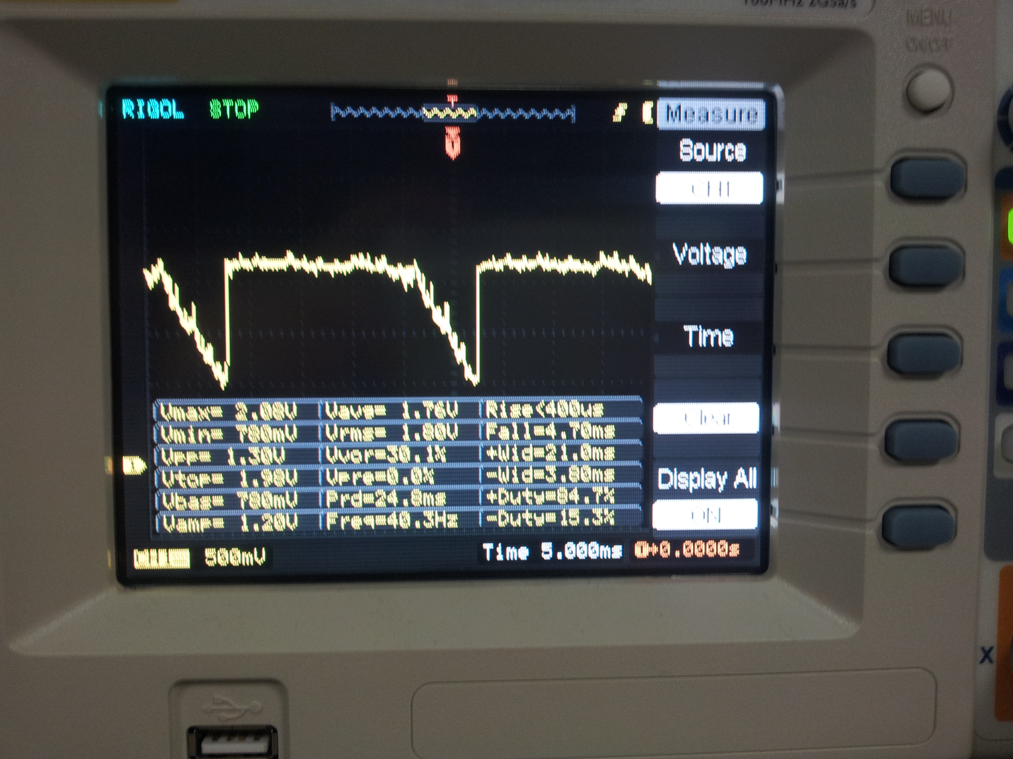

after going thru the amp this is the output i get. I dun understand why the min voltage has gone up to 2.5V from 0V after amplifying. (2011-12-02 20.29.27.jpg).

The signals from your DAC are extremely distorted. Distortion is high frequencies that sound like "zzzzz" which the LM386 amplifier is playing.
I think the input level to the LM386 amplifier is much too high which also causes severe distortion.
The 0.22uF coupling capacitor feeding the 10k volume control cuts frequencies below 73Hz but some of your signals are only 0.1Hz so the capacitor passes only the distortion.

Your micro-controller is making a distorted triangle wave.
Your power amplifier has its input signal level too high for its small allowed output signal level because its supply voltage is very low.

In post #22 you show two completetly different schematics:
1) The one on the left is from the datasheet and has an opamp.
2) The one on the right is yours that does not have an opamp and is wired completely differently.
Why don't you use the circuit from the datasheet and feed its output through a coupling capacitor and attenuator to the volume control then to your LM386 power amplifier?
The maximum output from an LM386 that has a 5V supply is 3V p-p when it drives an 8 ohm speaker. Therefore its max input is 3/20= 0.15V p-p.

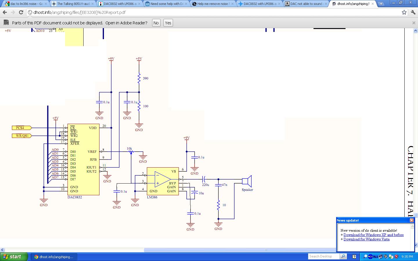

Sorry audioguru for all the mistakes. We have done the DAC and this is our current schematic however there is alot of noise and is overpowering our voice data. Is that any remedy to remove the noise? We placed a capacitor at the bypass pin 7 of LM386 because we were told that it helps to eliminate noise and its a must have.
Your new schematic does not have a coupling capacitor so the DC from the DAC is amplified 20 times by the LM386 which causes its output to saturate and produce severe distortion.
You added a capacitor between pin 1 and pin 8 of the LM386 which increases its AC gain to 200! Why??
The capacitor at pin 7 of the LM386 to ground reduces mains hum noise from the power supply. A 9V battery does not produce hum so the capacitor is doing nothing.
Please describe the "noise" that you hear. Is it severe distortion as described above?
If the circuit is built on a breadboard then the LM386 will probably oscillate at a very high frequency, get hot and produce severe distortion.
