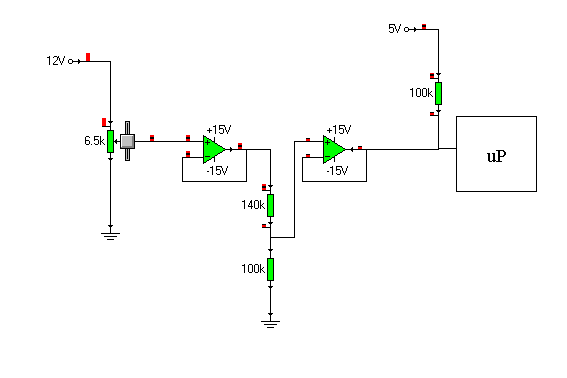

I have a electronics problem, ( well its a problem for a mechanical engineer anyway). I have the need to convert a 12vdc analogue signal to a 5vdc analogue signal so an amplification of approx 0.4. I've listed all the details below.
I'd appriciate an explanation of the cct but to be honest just a circuit would do.
Input 0vdc to 12vdc. This is produced from a 0 to 6.5 K ohms pot, which feeds another control system, clearly this means that I cannot affect this voltage by the cct that I attach.
Output This need to be 0 to 5vdc which is feed into a micro, which has a pull up resistor at 100K ohms fitted ( & I cannot remove this resitor. )
Many Thanks in advance
Arron

Thanks for your reply, I have a few questions.
If my Pot is 1/2 way ( 3k either side of wiper) then voltage at wiper = 6 volts.
If the potential diver has a combined resistance of 1.4K and shares a common ground with the pot then this will make the lower side of the pot 3K in parallel with 1.4K giving a combined resistance of approx 1.3K pulling the wiper voltage down to approx 2.5 volts. This would cause a large error on the control system that it feeds. I have not accounted for the 100k resistor that comes off the potential divider that is connected to 5 volts as I couldent get my head around the problem.
I'm sorry that I may not have described the problem adequatly. The pot is connected to a shaft and the pot acts as a sensor for shaft position, and is continually moving.
The ratio of the values quoted was correct, but the values themselves were too low (actually 2.4K in total, not 1.4K as you suggested).
You need to use higher values to prevent it pulling the voltage down.
Unfortunately the 100K you can't remove would tend to upset things, an easy solution would be an opamp buffer feeding from the output of the potential divider (which could then use high values) to the A2D.
Perhaps I misinterpreted your question. I was under the impression that the control system you mentioned was to supply the 0-5V signal, instead of being taken directly from the pot.
In that case, Nigel is on the right track, using an opamp to buffer the voltage at the pot wiper, and then using a resistive divider (one resistor 14k, the other 10k. Still, the 100k pullup will affect the accuracy a little, so if you want to improve that, buffer the output from the divider again before taking it to the uP.

That's a great help, & I'm sure that I can get it running now. I assume that a 741 would be ok as the opamp ?
Re: Thanks for your help
A 741 would be fine, you actually only need the second opamp, the value of the potential divider at 140K/100K is more than high enough to connect directly to the slider of the pot. Although if you did use both opamps you could reduce their values if you wanted to.
