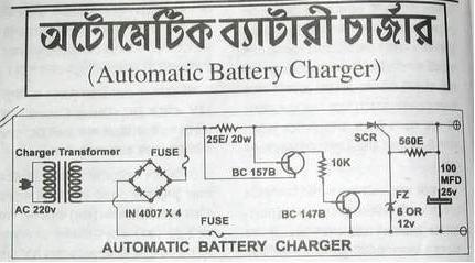

Hero999 said:
Well how would an automatic reset work then?
It wouldn't be safe to turm it back on when it's short circuited would it?
Hero999
by little modification above circuit i find my need what i want, you may think about it for ferther better modification.
Thanks regard
ataul
