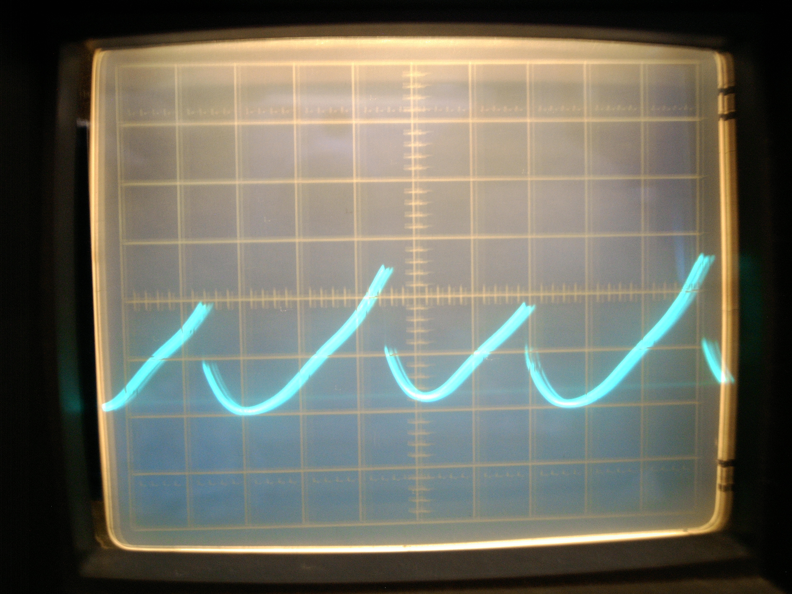

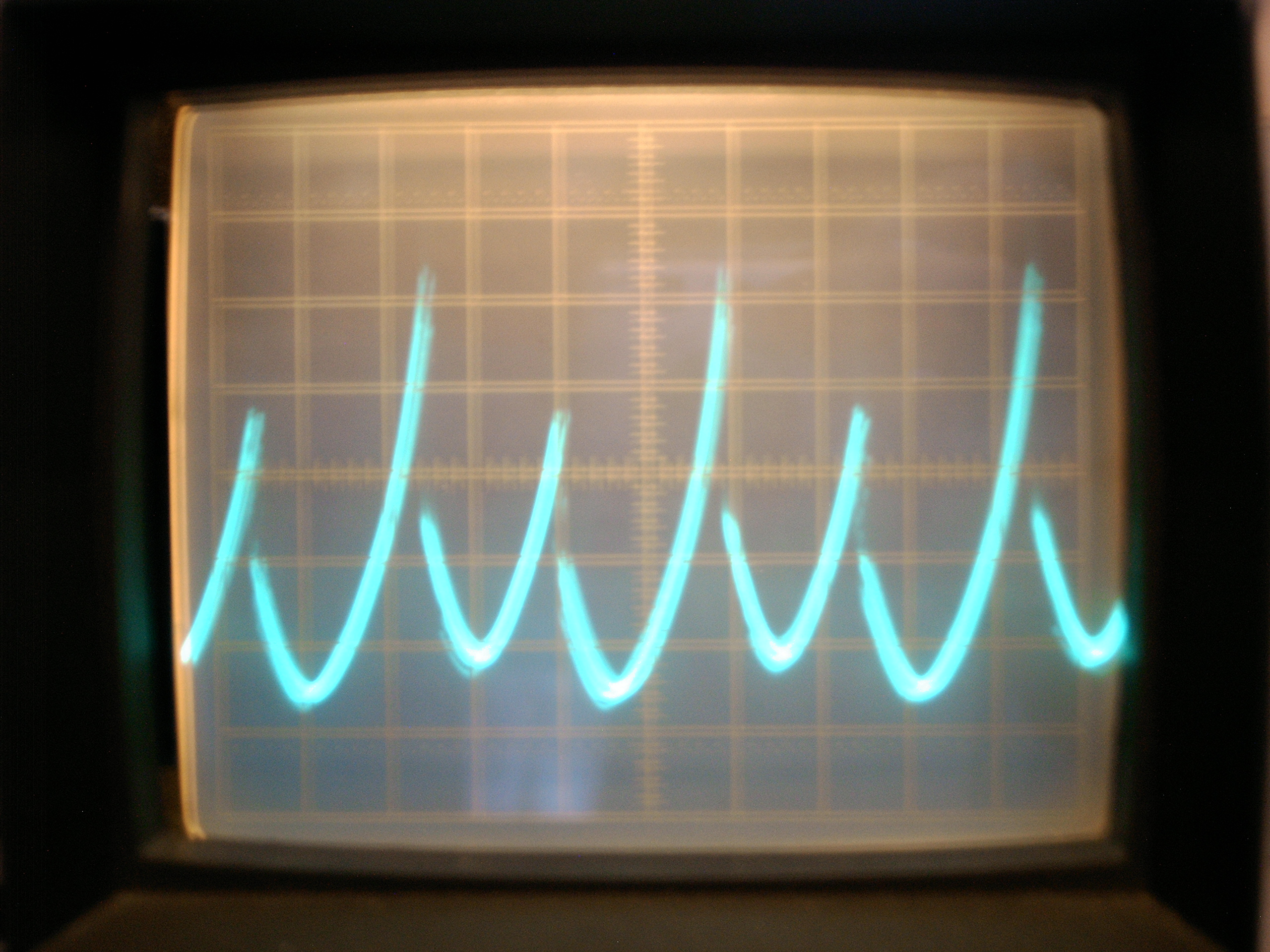

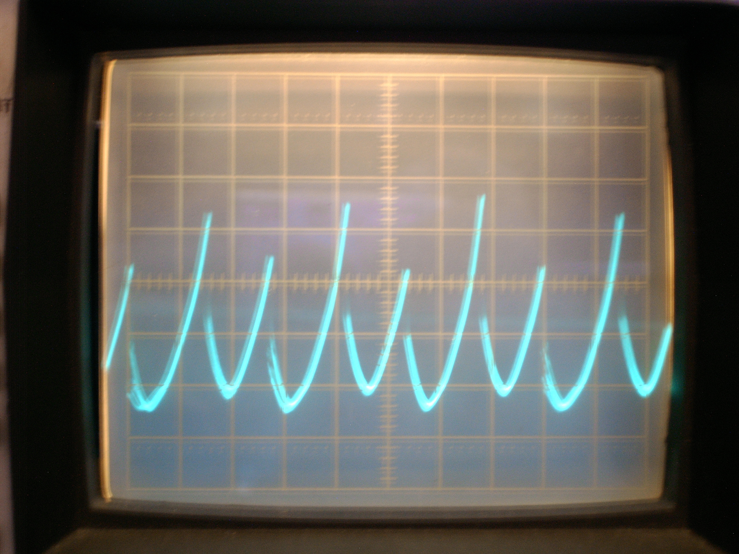

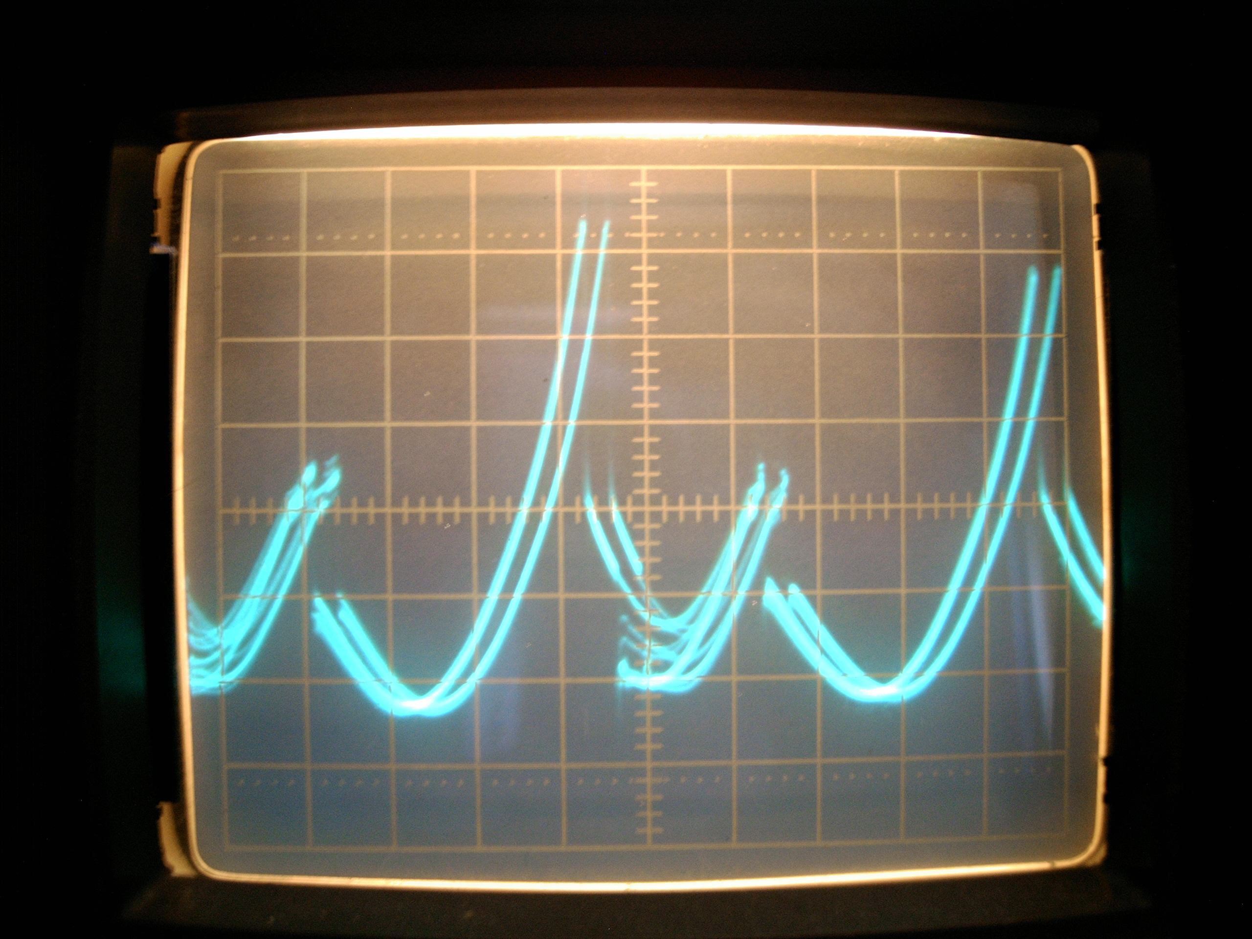

I've 'scoped the current waveform through a small cheap Chinese DC motor at different voltages to change the speed.
The 'scope was set to AC, the current was measured by connected a 1Ω resistor in series with the motor. One division represents 50mA on all waveforms.
1) 3V 2ms/div
2) 6V 2ms/div
3) 9V 1ms/div
4) 12V 0.5ms/div
Sorry about my shaky photography, my hand isn't that steady and the waveform wasn't always stable.
Assuming the motor is three pole, what's the speed?
