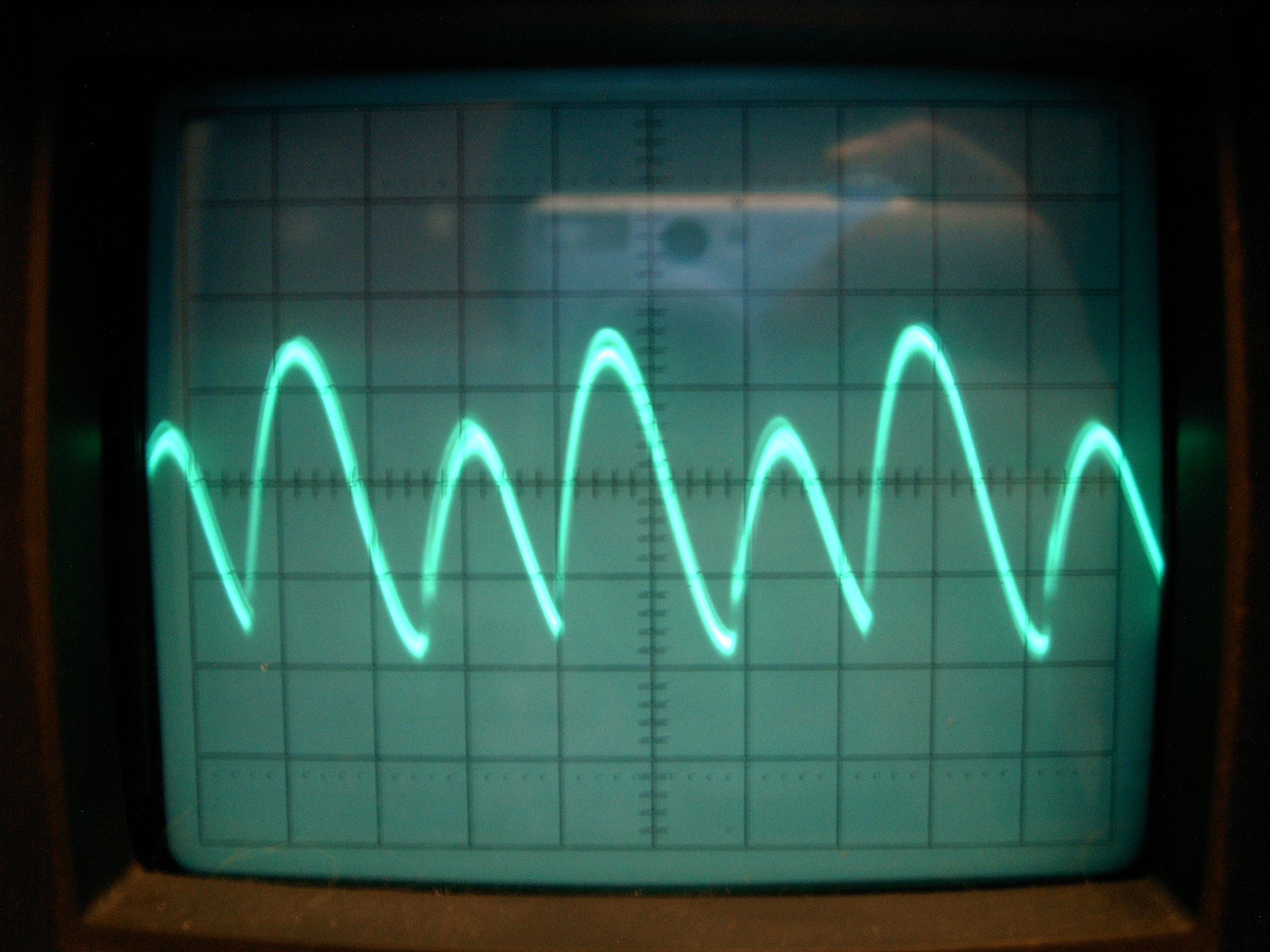

By my rough reckoning, @ 3 V = 5000 rpm
6 V = 10,000
9 V = 16,000
12 V = 19,000
Did by chance see of the RPM changed much with loading?
You're right.
I make it about 17000rpm@9V but it isn't easy to count the squares due to my shaky photography.
I make it 3.5 squares giving a period of 3.5ms, 60/0.0035 = 17,148rpm.
I'll see if I can count the pulses with my frequency counter, it might give be triple the frequency but I'll easily be able to figure that out.
Yes, the frequency does change with loading.

Here's a better picture at 9V.
I've also noticed that the waveform changes when the motor is run in reverse which indicates that the motor isn't completely symmetrical. This normally happens because of the ways the brushes wear when the motor is normally only operated in one direction.
1) Better picture, 9V 1ms/div, 50mA/div
2) Waveform when connected in reverse, same 'scope settings as #1.
I've tried using a frequency counter but it didn't work. I measured a frequency of 30kHz which seemed to increase when I put a load on the motor. The counter is probably triggering at a harmonic and is changing when a load is applied (the waveform also changes shape when loaded). I tried adding a low pass RC filter 680R and 100nF but it didn't work. I also tried a 22µF capacitor in parallel with the motor and a common mode EMC choke to no avail.

Good point. Looking at the waveforms, maybe get a good signal for freq counter by differentiating out that very fast edge I can see there on all the traces. Maybe try first putting the counter input probe near, but not touching, to try this out first.
I reckon differentiated pulse could be buffered up with a capacitively coupled 74HCsomething gate connected in linear mode (you know, with some neg feeback round it).
