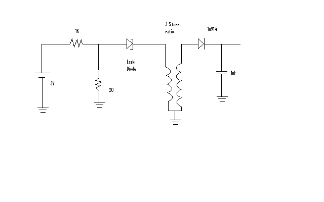

What about something like this (attached)? Its a simple oscillator feeding a step-up transformer with an output rectifier.
Because it's an IC and for some weird reason he doesn't want to use an IC
Perhaps, but it might be a misunderstanding on his part, that IC and a couple ceramic capacitors is all it takes to get a regulated 5V from 1.8V. So any 2 nickels or 1 lithium.

He needs to ask his teacher how much current is needed at 5V and if the 5V needs to be regulated as his battery voltage runs down.
sorry for the confusion. i would like to just do it the simplest way so IC it will be BUT im not sure how to calculate which actual chip to get based on its specs, etc. i ran across these **broken link removed** which suggests to use the **broken link removed**...to sum it up i'de prefer using the IC but don't know how specific those things get. thanks
also: i need the constant 5v from the 2xAA batteries in order to power an optical joystick..
And for the minimal current required by an optical joystick and the additional requirement of a constant 5V, I will again recommend a REG710 since it will maintain 5V down to 2.5V in and stay in spec (logic levels call out 4.5-4.5V) down to about 2.3V.
