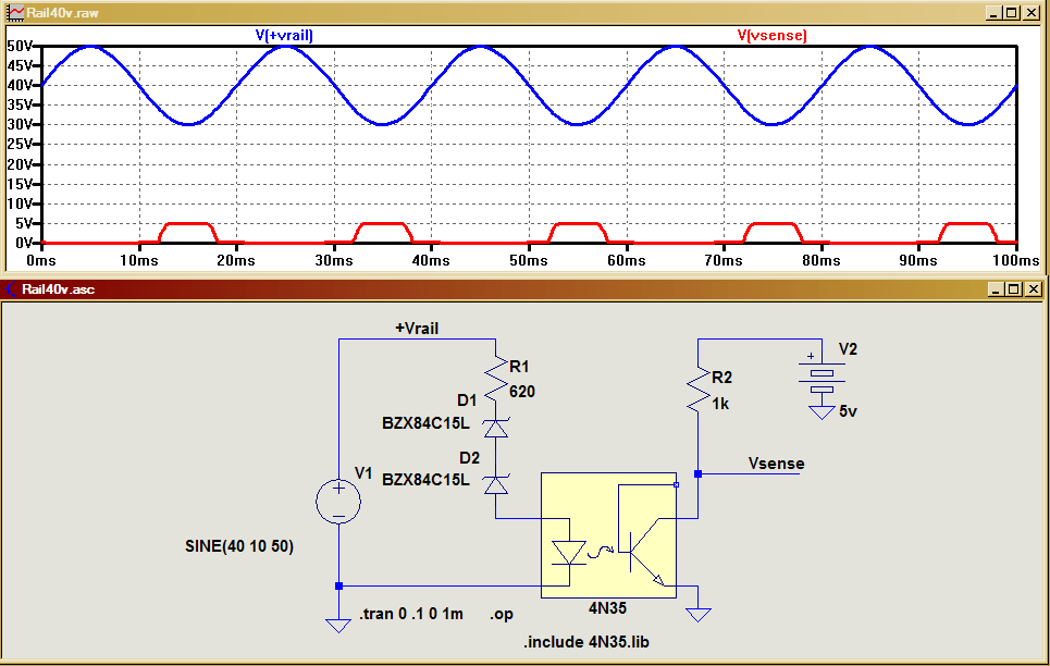

Hello, I am currently working on an audio amplifier that makes use of +/- 40 VDC.
This project encorporates a digital control panel, where I would like the system to be able to alert the user when one of the supply rails is at an unusual voltage.
I guess wha Im looking for is a device or circuit that can monitor each 40vdc rail and alert the user if, most importantly, the rail drops to zero and if possible, also alert the user if it is say, 30v or less or 50v or more, although this is less important.
I realise that a comparator may be the answer, but is this voltage too high for it? How could I provde a voltage reference for thr comparator?

Yes, use a comparator, run from a lower voltage using the a regulator such as LM317 and LM337 or a zener diode and monitor the supply voltages using potential dividers.
It's possible to power a single LM339 using a +/-15V supply which will enable you to use two comparators for monitoring each rail.

No, if you use high enough values, the current can be under 1mA so standard 250mW resistors can be used.
The LEDs can be powered using the regulator which probably won't even need a heatsink.

So a 30v zener doesnt conduct until there is 30v present, when this occurs (indcates a 'good' rail) the outpu of the zener is connected to high-value resistor revider which then operates a optocoupler. Is this the simplest but effective way of going about it?
You're overcomplicating things.
You could just put the zener in series with an LED, which will only light when the supply voltage exceeds its breakdown voltage, plus the forward voltage of the LED which is normally 1.8V for a red LED.
You could also use a potential divider and an LED but it won't be as accurate.

Just connect a 680R resistor in series with the LED and a 30V zener.

Morning Mike,
Would you confirm at what 'low rail voltage' you want the change in logic level to occur.?
Anything less than about 30V is regarded as low. Anything higher than about 45V is regarded as too high. 40V is the nominal voltage.

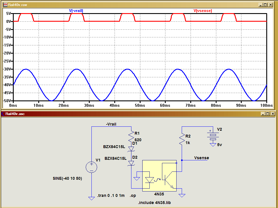

Look at this image, its for the +40Vrail, the -40Vrail would similar.
I have used two 15V zeners for the 30V.
