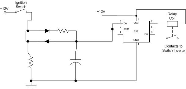

I have an invertor in my car, and would like to have to switch off automagically when i turn the key on & off, I know I can get a 12V ignition line (same line as what signals my carphone to turn on & off) to drive a relay for the invertor.
However, I would like the invertor to only switch on after 20seconds (approx?) after I turn on the key, and turn off approximately 20seconds after I turn off the key. I would also like a override toggle switch for Off, Auto, On ... and if possible a LED to indicate that the invertor is on.

Attached is something that should work. If you can put this together then we can fill in the missing details.
Thats brilliant, what size resistors & capacitors will I need to get me going?
Is the 12V line going into pin8 a permanent 12V supply? or the same supply from the ignition line?
See attached schematic. The 12V line into pin 8 must remain connected to the battery for the circuit to operate. It will use about 8 mA which is not too taxing on a car battery. The relay can be replaced with a solid state type if a suitable relay cannot be found.
It is prudent to put a .1 uf capacitor across pins 1 and 8 of the 555. It is also prudent to put a 15 volt zener diode, or transorb, across pins 1 and 8 to make sure voltage spikes do not damage the 555. I did not show these items on the schematic.bidir1.jpg

Ok, so I've built the circuit you gave me, and it works very well, I could only make up resistors to get 91K (stupid irish shops..), but still has the desired effect...
about the zener diode, does it matter which way it is orientated?

I'm glad to hear it worked. Thanks for letting me know.
The resistors along with the capacitor determine the time delay. Larger value resistors and larger value capacitor, give greater time delay. The topmost resistor determines ON delay. The lowermost resistor determines OFF delay.
The cathode of the zener (the end with a band on it) should connect to pin 8 (+12 Volts). Of course, the other end (the anode) connects to pin 1.
If there are voltage spikes in the +12 volt power with high energy content above 15 volts, the zener will overheat and short out. I can't say this is true in your case, but a fuse between the battery and the circuit is a good idea in any case. Should you find that the fuse blows because the zener conducts too long and overheats, then you can put a small valued resistor (500 ohms, max) between the +12volts from the battery and the cathode of the zener to help absorb some of the energy of the voltage spikes, preventing the zener from getting damaged. Automobile power can be quite dirty, with lots of voltage spikes. The larger wattage the zener, the better too.

Disabling the timer's control over the relay, thus forcing the relay to be energized by holding the RESET line low is fine. Another way is to place switch contacts in parallel with the relay contacts.
Your green LED can be placed in parallel with the relay coil. A resistor must be put in series with the LED, say 470 ohms.
Your red LED can be connected between pin 3 of the 555 and the ignition switch, with the anode at pin 3. Again, a resistor must be put in series with the LED, same value as for the green LED
ok, i've done that, although, the red LED doesnt operate as expected - pin3 goes high while the relay is off, currently the red LED glows dimly (while the capacitor discharges) after the relay is off, and the ignition line is disconnected, am I going to need a logic circuit (AND) to achieve the red light - so that there is a signal from pin3 and the ignition for the LED to work? :)
Further reading leads me to believe that a transistor could work too?? pin3 to the base of the NPN transistor, ignition signal into collector, emitter to ground??
Arrr, yeah I see my error. Do you have an unused pair of relay contacts? If so, they can provide a ground for the red LED instead of pin 3.
Yeah, sort of. You would need a resistor between pin 3 and the Base, say 4700 ohms. The Collector connects to the ignition switch through the red LED (anode to ignition switch) and 470 ohm resistor. Emitter to ground.
