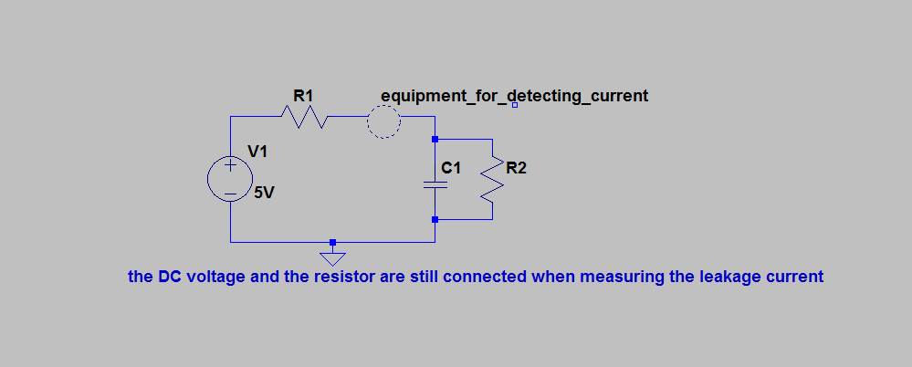

Hello MrAl,
Thank you very much for your detailed explanation. I think I finally "get the picture". :)
In your method, we don't have to know the capacitance, I think that is of great advantage over mine.
One more thing to be sure of, when the cap voltage stabilizes, we don't disconnect the DC voltage and the series resistor from the cap when we measure the leakage current, right?

Hi again,
Your diagram makes everything more clear.
Yes, everything stays connected so that you can read the current through R2 with the meter and the current will be coming from the source voltage. You can see from that diagram that when the cap charges up it does not draw current any longer so the only thing left to draw current is R2.
When you need to measure the leakage current at a specific voltage you would charge the cap until the cap voltage reached the target value. If R1 is small then that means it will be almost the same as the source voltage.
Your idea for the measurement is good too though. If you want a more average reading that might do it because the leakage may be a function of voltage:
Vc=Vs*(1-e^(-t/(R(Vc)*C)))
and so anything that depends on voltage might give a more average-like reading. If you really wanted a more exact average reading though you might have to use several test points and then average the results.
Also, if you dont have a current meter handy then measuring the time may be a good idea as in your method :)
Might need a scope though.
That is correct. The only time you disconnect the power source and meters, would be when your going to discharge the capacitor. There are special discharge sticks for the higher rated (kV) capacitors. You can get by with a resistor and an alligator clip jumper for lower voltage rated capacitors. Remember, this is a safety issue and the only one who has a keen interest in you IS you.
