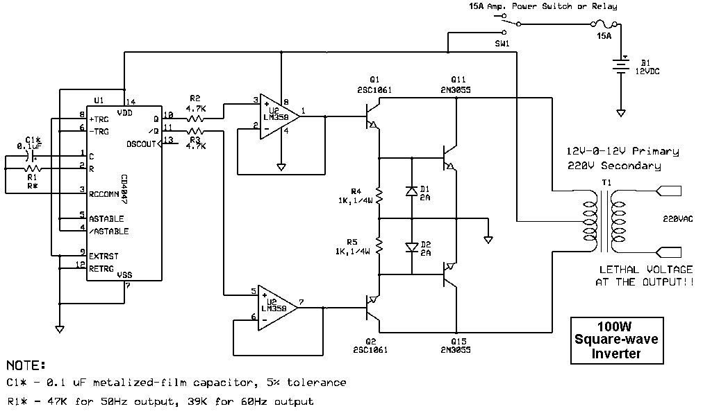

That showed me i guess! thank you for pointing out that little detail. in any effect i have a request. is there any circuit available that uses a transformer and transistors as switching mechanisms to produce a square wave output of 120 give a 12 DC input. simplicity would be preferred.
The simplest square-wave inverter uses a CD4047 as its push-pull oscillator and it drives two Mosfets that drive a center-tapped transformer.

i know i am asking too many questions without any having any of them answers but this question is specifically for audioguru. I looked at your revised circuit with the cd4047 chipset and i was wondering if i could use this for my purpose. I need to know whether i can use another chip as i have non available to simulate. also i was wondering whether this circuit could be manipulated so that the input dc voltage be 12V and 2A. if so what changes do i have to make to the circuit and what do you think and approximated output power might be. also, what are the part numbers for the diodes. attached is your inverter for reference.

What is your current-limiting circuit?
You can make your own CD4047 with about 10 other Cmos logic ICs.
Usually a simple inverter like this is driven from a lead-acid battery that has hundreds of Amps of current available. It uses a fuse for overload protection.
What do you think the approximated output power might be?
My schematic shows 100W max continuous output power. The battery will need to provide 120W (10A). I am just guessing since nobody has built it.
If you limit the battery current to only 2A somehow then the battery power is 24W and the max output power is only about 19W.
The diodes are shown as 2A (or more) diodes. Their voltage rating is 30V or more.
