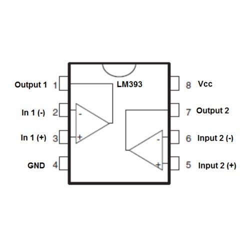

Also, I looked at the LM393 chip and...
Well, VCC and GND is easy enough. But I don't understand the rest. This chip is supposed to compare the normal voltage and send a signal when it detects a change.
Should I wire the vibration sensor to pins 2 and 2, and use the output 1 ? Is it that simple ?
No, the IC contains two comparators, you need to use one or the other - it doesn't matter which.
