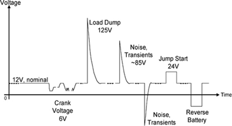

You should protect the LM10 from "load dump", using a TVS :

Dont forget to use a TVS solution on the circuit power supply. And place a .1uF ceramic disk
in parallel with a 10 uF or so cap on circuit power pin. Close to OpAmp/Comparator power
pins.

still recommend a TVS for load dump issues.
