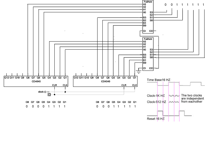

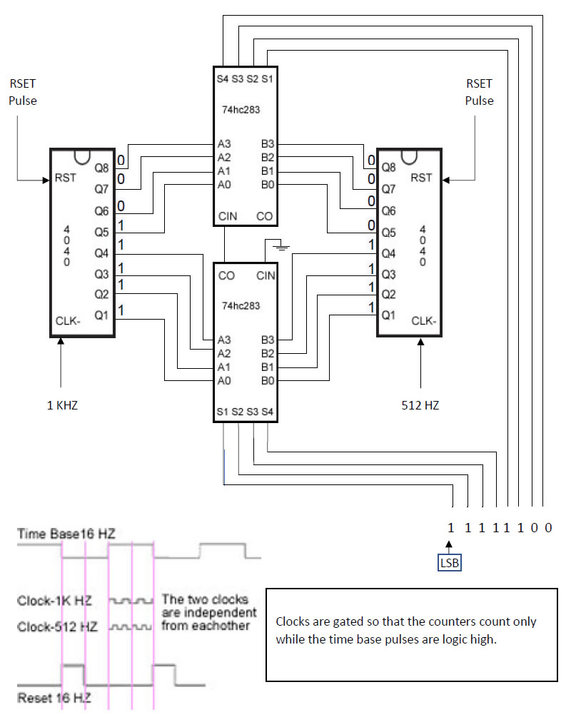

I am experimenting a circuit for adding two numbers represented by two digital counters and two cascaded 4 bits adders (74hc283). I tested separately with cascaded 74hc163 and with asynchronous 74hc4040 counters and I ended up with the same questions.
I feed one of the counters with a 1 khz com signals and the second counter with 512 hz signals. All signals are well formed square signals.
I use 16hz crystal-controlled time base. The counters count during logic high of the time base that is 1/32 sec or about 31 msec. The counters are reset in the second half of the logic-low of the time base.
When I verify the outputs of the first counter, my prob realizes pulses at some of the outputs and I consider them as logic high. So that the output of the first counter is binary 00011111 to represent the 1khz clk input, almost as expected. The output of the second counter is binary 00001111 to represent the 512 hz clk input also during the 1/32 sec. So far so good.
I feed input a[] of the cascaded adders by the outputs of the first counter and input b[] of the adders by outputs of the second counter. My expectation is to see the correct sum as binary number 00101110 at output s[] of the 8 bits adder, the same way that I see the correct binary numbers at the outputs of the two counters. But instead, I see binary 00111111 as the sum. If I change the clk input of the first counter to 2khz and I leave the clk input of the second counter as it was 512 hz, I see binary number 01111111 instead of the correct sum 01001110 as sum at outputs s[] of the adder. If I change the clk input of the first counter to 512khz like the second counter, I see the correct output of 00011110 as sum at outputs s[] of the adder
Is my expectation to see the correct sum at output s[] of the adder justified while the counters are counting during the logic high of the time base?
If so, why do I get wrong sum?
If my expectation is wrong then how am I supposed to get the right sum while the counters are counting during the logic low of the time base?
Please note that it is not about what kind of counters I am using. It is about the wrong sum no matter which counter I use.
Thank you

The "sum" should the running total during the count.
If you are using a logic probe, you will not be guaranteed to see the correct values.
A pulse display on a logic probe could occur on a pin that cycles high then back to low as the count accumulates.
You need to either use an oscilloscope to verify the final count before reset, or change the logic temporarily so the clock is gated off or frozen rather than the counter reset, to give a set of static outputs on the counters and adder.
Or rig up manual clock and reset circuits to you can step the counters and watch the results.
I was about to suggest that you check that the carry connections are correct, but I think that rjenkinsgb has the answer.
The LSB of the sum will be changing at 1 kHz and at 512 Hz, so basically changing at 1512 Hz. It will always read as pulses with a logic probe. You need to speed up your reading by using an oscilloscope, or slow down the signal by stopping the clock to take a reading before resetting.
When both counters are running at 512 Hz, both outputs are the same, so when added, the result is always even, so the LSB will always be 0, which is what you are seeing.

About using the oscilloscope suggested by rjenkinsgb, I also checked each output pin by my oscilloscope and I saw pulses of different frequencies at the same outputs of the adders as I saw with the logic probe. Is that how you meant by verifying the final count by oscilloscope? because I cannot think of another way Of using the oscilloscope for checking the final counts and the sum.
If it's continuously cycling and resetting as you describe in the original post, trigger the scope off the count/reset signal and look at the final state of each pin as the reset occurs.
Or you could add a single D type latch, clocked by the start of the reset pulse & with a flying lead on the D input that can be connected to any device pin - the counter or adder outputs.
Add a LED & resistor to one the D type outputs and you should get a steady output showing the final state of that pin at the instant the reset happens.
Thank you for the tip. As I mentioned in my original post, I can read the expected value at the outputs of the counters at pulsing pins. It is all about the sum at the output of the adders that is not right.
1- So why shouldn’t the output of the adders show correct sum the same way as the counters show correct output at pulsing pins?
If my expectation is wrong for seeing the output of the adders the same way that I see the output of the counters, then I want to try the test method which you suggested. You expect to use the reset pulse for showing the outputs of the counters the moment that the reset happens.
2- Why do you expect the outputs of the counters remain to be seen from the moment that the reset pulse is applied? The data sheet of 74hc4040 shows that when reset is applied all output are set to low (in a matter of nanoseconds).

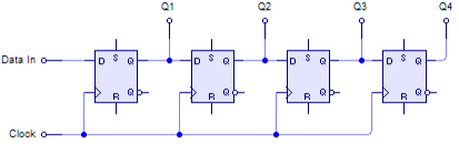

Look at the way any synchronous register works, like a shift register made of D types, as the image below.
The data is latched at the same instant the preceding device is clocked or reset, and the propagation delay through the preceding device means the "old" output is stable long enough to be captured by the next stage.
You must not have any extra gate delays in the clock though - it must be the same signal, or the preceding stage could be delayed by an inverter, if the polarities are wrong; eg. if the new latch needs is positive edge and the reset is negative, add two inverters in line with the reset and take the D clock between the two.
