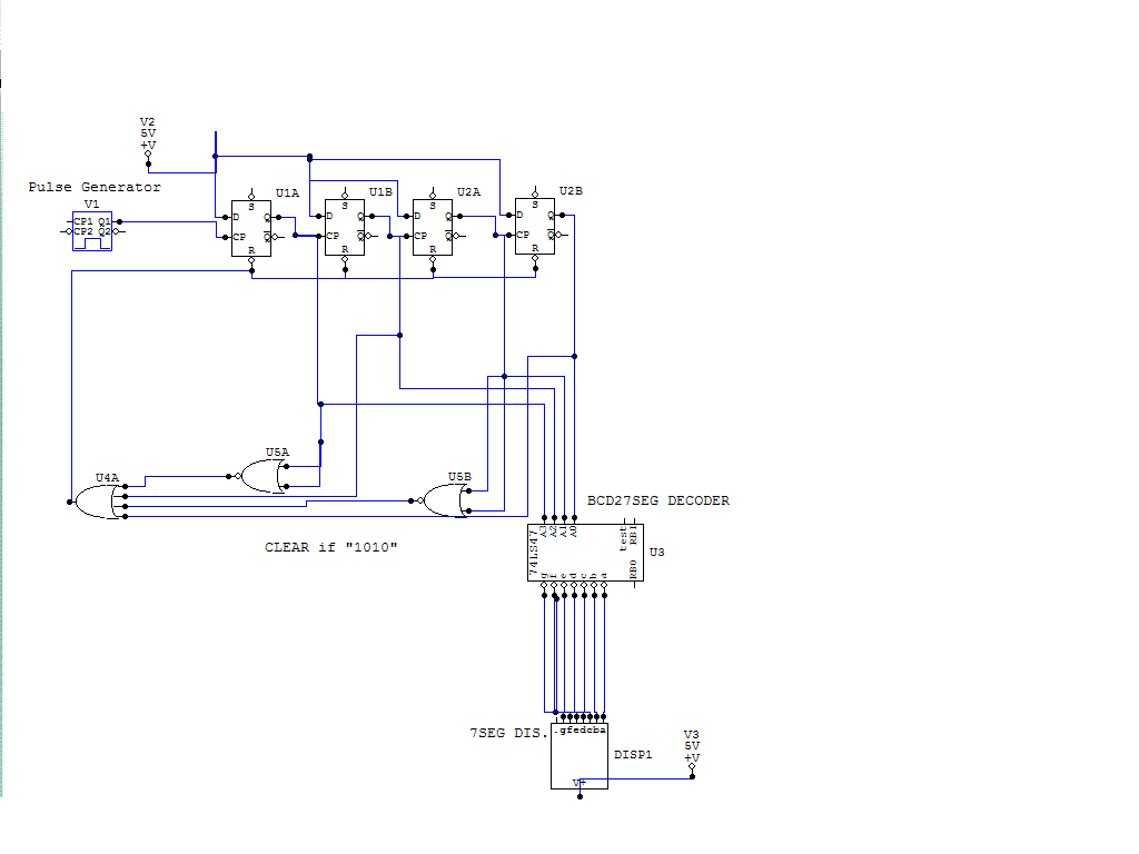

Hi you all,
I learn Electronics at school and I found it very intersting.
I decided to improve my skills so I took on myself a nice project.
Building a digital clock.
How ever , I dont want to use ready chips.
Only the basic compontes: Flip Flops,gates,decoders and Pulse Generators.
Therfore there werent post that might helped me, all of them are contain
kind of uknown compontes (to me).
As a start I tought how to manage the first numeral seconds:
(Units of Seconds (0))
4 T FF
all the T inputs will get +Vcc.
Decoder BCD to 7SEG
So please take a look at the picture that attached to the post
and tell me if its right and how can I now connect it to the Ten Seconds(10).
i know that when the "Q"'s value is 1010 I need to do a reset to the
Units Seconds and add a pulse to the Ten seconds - but I dont know
how....
Please help by adding your circuits too.
Thanks!!

You can do the trick like this.. Circuit attached..
I have attached ZIP file containing the Circuit Maker file...Just open the file in circuit maker.
You can reset on desired position using AND gate.
Hope it will help.
Ur project is going to coastly...

You can replace it with flip flops and gates. The 4024 data sheet contains the complete circuit diagram.
Or google for "ripple counter".

Can you help me a little bit and now show me how to connect the
seconds to minuts?
And another question,
why you connected the Output wire of U5A to the U1 MR and to the U3 CP ?
Thanks.

Answer of ur first question,
Make the same circuit as u have made for the Seconds and Divide ur Clock cycle with 60(u can use two or three Johnson Counter) and connect the output of the divider circuit with the circuit(CP) u have made for minutes.
Answer of ur second question,
For example u want to apply a condition. What will u use for it!!! U can use and gate.. We want that after the 9 there should be zero. At the position of 10 we connect the AND gate and it's output is connected with MR(of U1) and CP(of U3)..
Now how it works,
As the 10th pulse reaches at the U1 it will convert this input into binarray. it's output will be "0101" now AND gate will perform it's action it will makes it's output High because both of it's input are High. AND's gatte out will reset the U1 to Zero. And the Same time it will incriment into the 10's digit of Second..
Hope this will help.

Is there any replacement for the Output wire of U5A to the U3 CP ?
Ive been told that this wire doesnt allways works.
