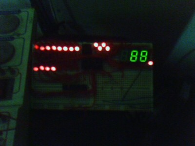

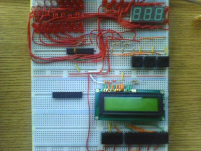

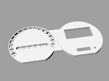

I also attached some pictures of what i have done on breadboard, but the aim here is to make a pcb, and i cannot afford to make a mistake.

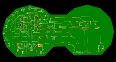

I am no longer aiming for one big board like in my picture, but rather a small universal board about 2"x2", with everything connecting via cables. (the last pic is where i got to before starting this thread)

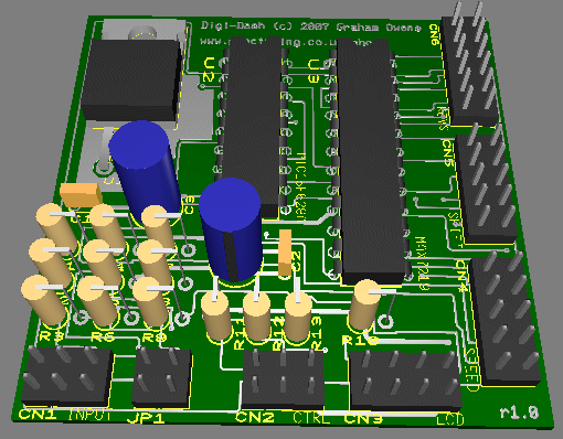

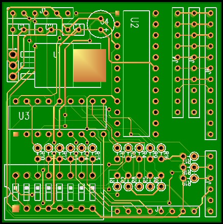

I have decided to remove the extra 6 dip switches, that i was trying to read, as at my current level with analogue electronics it is beyond me. I have also replaced the 2 dip switches for bypassing the potential divider with simple jumpers (as i have these, and i dont have 2 way dip switches).
So the board is now designed, and i have attached a 3d mockup of it. Can anyone foresee any problem with the component positions? from an electrical noise point of view??
All being well, i'll have my first batch of professionally made pcb's back in about 10 days :)
thanks for all the help and assistance i have been given, and i'll update you when i have my board back if they work.
In the meantime im gonna study more analogue electronics.
