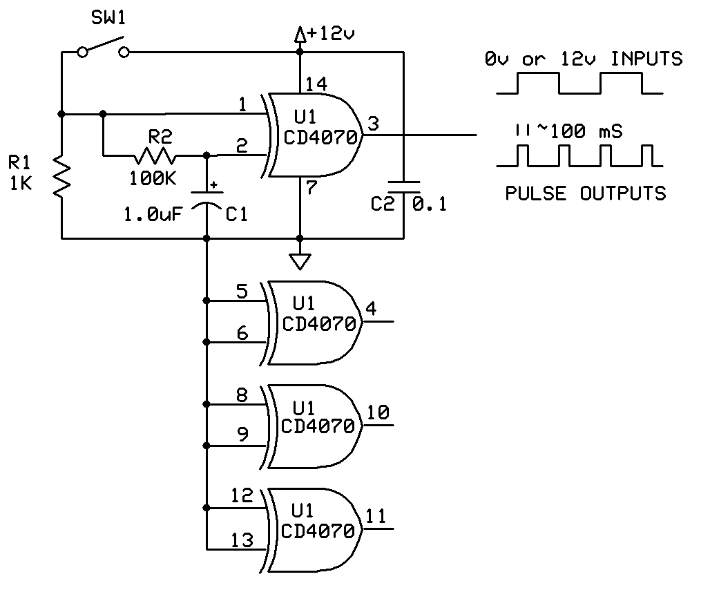

an edge triggered monostable....a 555 timer chip would do..
Look at the link, about two thirds of the page down...
Number 8 in the sequence..
The circuit is an "edge detector". Attached using CMOS version. R2/C1 sets the output pulse width. SW1 just simulates the input square wave.

The 555 timer circuit looks like it defiantly does the job that i need.
But Heres a question on the edge detector circuit.
ken
This will give me a pulse on both the rising edge and the falling edge. How would i modify this to be just rising edge?
-Ethan

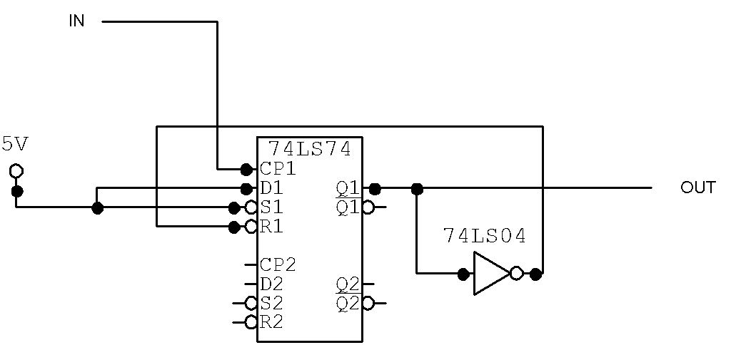

74HC123 can be set for rising or falling edge but will not respond to both. Time is set by RC.
a small capacitor coupled to a pull down resistor on the target might be adequate, I've used it to latch a 74xx573 in the past.
The attached gives a very short positive pulse on the output for each rising edge on the input.
