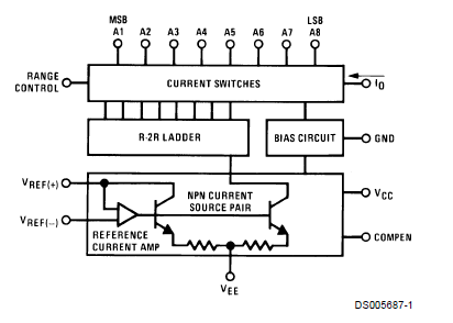

Eric, the DAC sources current, so the op amp needs a negative supply, and the output of the opamp will range from 0V to -xV, where x depends on the feedback resistor.
Mike, DAC0808 sinks current.**broken link removed**
