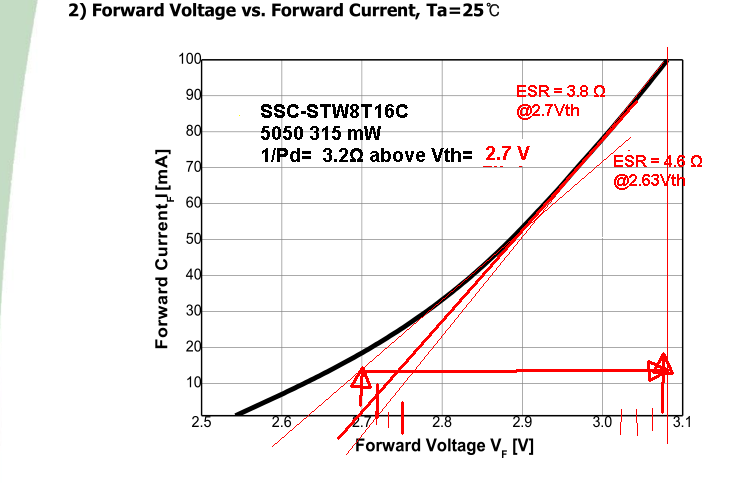

I have successfully modeled all diodes for Vf vs I with a linear approximation using ESR and a threshold voltage near 10% of rated current. This works well for simulation confirmed with lab tests and datasheets with expected tolerances for ESR, whereas threshold voltage is fixed for each chemistry.
Never assume all white LEDs are 3.3Vf, 5050 LEDs have lower Vf from lower ESR with higher power rating.
For these diodes, white SMD I choose 2.8V depending on pulse mode rather than DC.
e.g. SSC-STW8T16C 5050 are typical of this style ( picked as cheapest at Digikey )
315mW max with suitable heatsink
Vf 2.8~3.3 , 8.2Cd Warm White
The ESR * Watt Rating product (for all diodes ) ranges from 0.5 for the best and ~1 for nominal designs.
For this class of LED Pd= 315mW and my Rule of Thumb , Pd(rated) *ESR = 1 nom. depending on several variables.

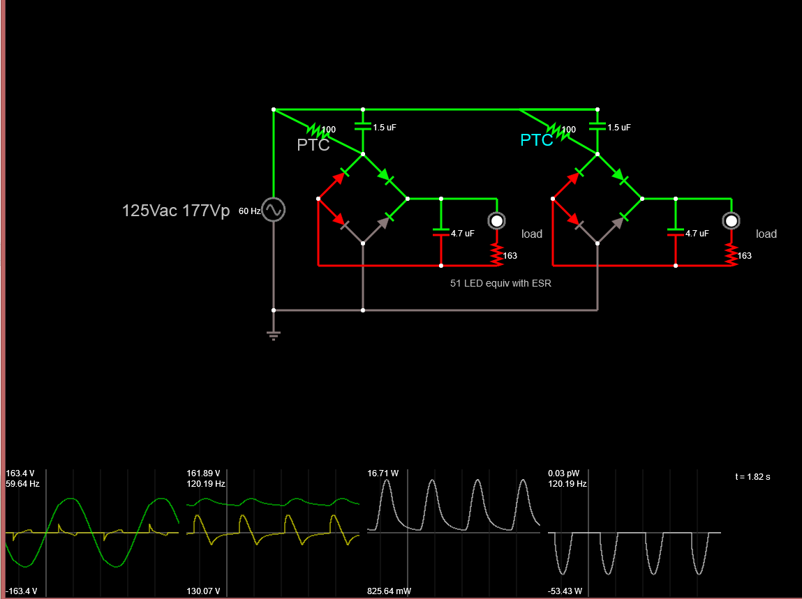

The best way I see of salvaging this design with some line tolerance is to add ~=100 Ohm PTC's (Polyfuse) to supply more pulsed current. Doubling C also works at the risk of more line sensitivity.

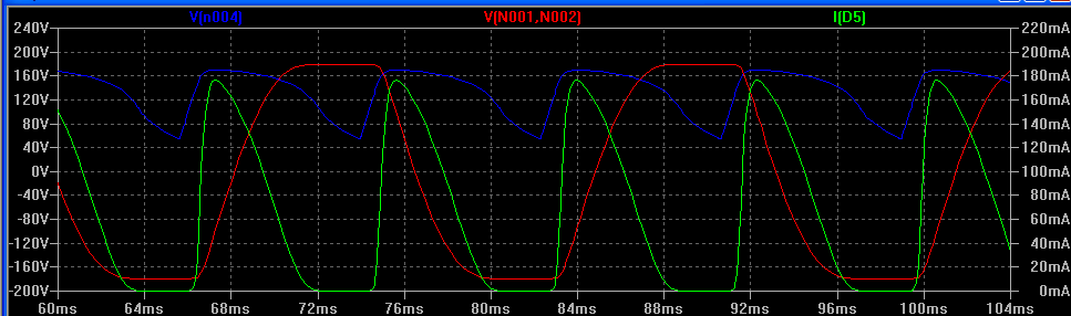

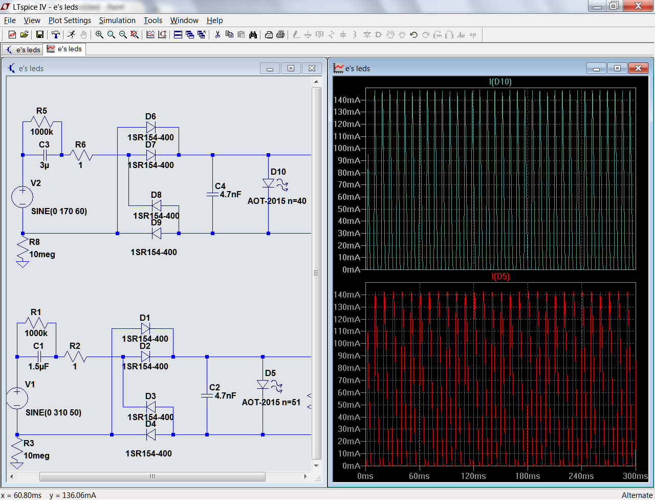

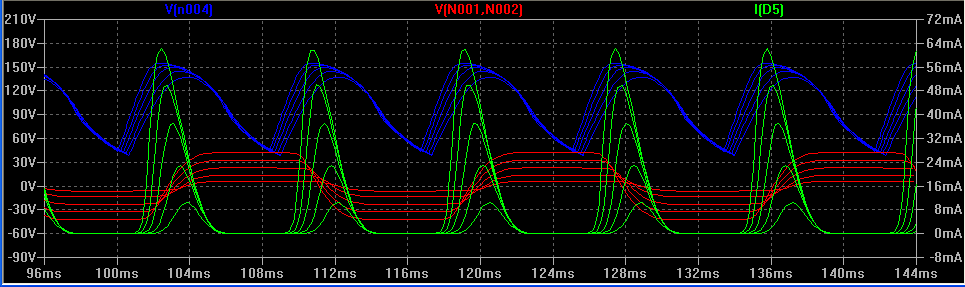

Here is 1.5uF, 3.0uF, 4.5uF and 6uF.
Red is HV capacitor voltage.
Blue is LED voltage.
Green is LED current.
I agree Ron but the voltage drop across rising values of C to < 10% of the line voltage and thus prone to flicker with line or load variation in the home such as electric heaters turning on, whereas a 100 Ohm or 0.1A Polyfuse or thereabouts would also boot current and adjust with slow line changes. In the end it is a poor design for low cost.
We all agree this is a bad idea.
Here is a try at varying the line voltage.
Green trace is LED current.
Voltage is peak not rms! 140V, 150v, 160V, 170V, 180V
150pk = 106, 160pk=113 rms, 170=120 rms, 180V=127
Thanks guys. Yes, a poor design.

Tony : Implementing a PTC would allow to cope with 127-130VAC; but does nothing for spikes protection, right ? Will see which transzorbs values reside in my bins.
Glad we are all on the same page.

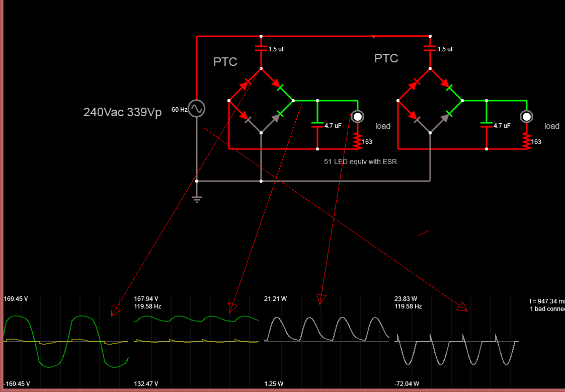

Actually I think his hunch that this was 240V only for 30W is correct.
I est. close to 20W avg (-72Wp) with 240Vac 339Vp
Tony : Implementing a PTC would allow to cope with 127-130VAC; but does nothing for spikes protection, right ? Will see which transorbs values reside in my bins.
Yes I agree with that.
The LED's act as high power zeners with current limiting by series impedance at risk of exceeding ratings, but then no big loss ;)

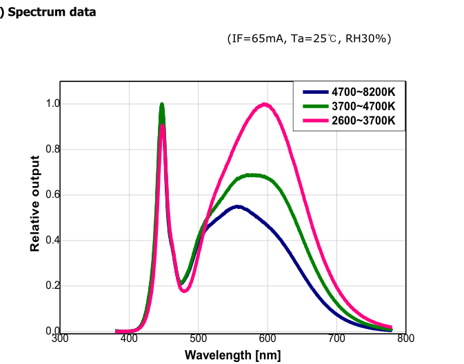

This demonstrates the balanced RGB still is not full spectrum lower level deep red wavelengths in White LED's

Well, if they are E's LEDS at 3.8 Vf it's probably to many. He is already at Tony's 2.9, so I left it at 3.3. :D
I think at 25 the current is over 50 ma.
One more time.
  • e's leds.asc

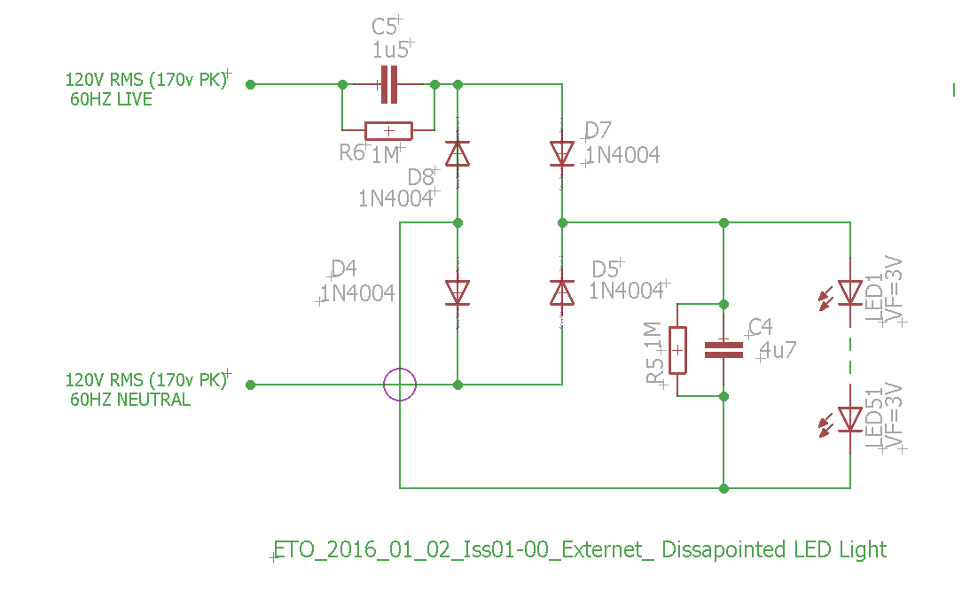

Hi.
Bought this 30Watt
----> **broken link removed**
with 102 leds, supposed to be for 85 to 265 VAC; gives less light than a 15Watt fluorescent CFL.
Supposed to have cree brand leds, but they do not tell the type/model in order to measure/test if the bulb is correctly built/labeled/driven.
Two equal circuits inside are each a 1.5uF/250V capacitor in series with a full wave rectifier to 4.7uF/400V electrolytic filter capacitor feeding series of 51 LEDs, no limiting resistor.
1.5uF at 60 Hertz result in Zc = 1768 Ohms.
A series of 51 white LEDs assumed at 3.3 Vf result in 168 Vf
120V AC after the bridge rectifier and filter are supposed to yield 170V DC
Measured Vf of one LED, shows 2.82V when bulb is lit;
AC supply measured 120.4V;
Capacitor drop measured 20.4V AC.
20.4VAC in 1768 Ohms = 0.011 A
So there is 100VAC / 141.4 V peak into 51 LEDs, resulting in 2.77Vf for each.
Seems LEDs are underdriven.
Do I raise the series capacitor to 2.0 uF for Zc = 1326 Ohm ? Or more ?
Or, eliminate the mains bridge rectifier/capacitor/filter and connect the two sections of 51 series LEDs in counterparallel to mains ?
Or, short circuit a few LEDs to raise Vf and If ?
Or, could the bulb be mislabeled as for 120V and it is intended for 240V ?
Or, what would you do ?
Schematic----> https://s588.photobucket.com/user/Innernet/media/P1010590_zpsn1ztzgxb.jpg.html?sort=3&o=0
Hi Externet,
Yes, your LED string would be struggling with 120V RMS (170V peak) at 60Hz.
There are two aspects to the design:
(1) the amount of energy transfered during each half cycle of the input sine wave; this is dictated mainly by the value of the input capacitor C5.
(2) the voltage of the transfered DC energy stored in the second capacitor, C4; this is defined by the ratio C5/C4 and the current drain from C4.
Try connecting the points circled in purple on the schematic below: that should fix the problem, although it may be necessary to adjust the value of C5 to get the brightness that you want.
To test put a 220 Ohm resistor in series with the LED string just to play safe.
Be interested to know how it goes.
spec
PS: The four rctifier dides shown on the schematic have no special significance: they are only there because I was too lazy to get a bridge symbol from the parts library.
