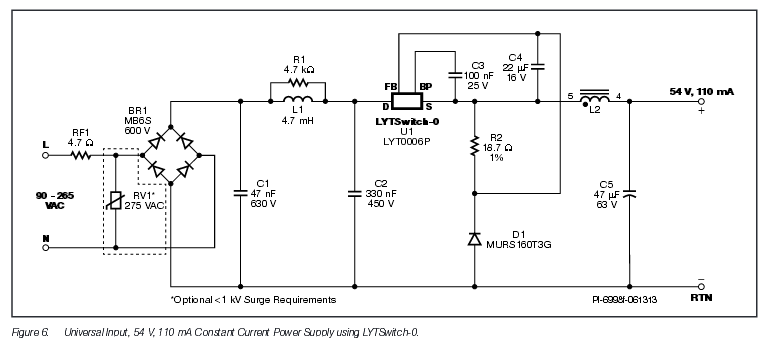

If real illumination efficiency is needed , perhaps led selection and pwm type efficient driver and proper orientation of the leds for a proper beam of light are main cafeteria IMHO
Here is a simple constant current LED circuit. Non isolated. 90-265Vac.
I like this little PWM. More complicated than a bridge and current limiting cap!

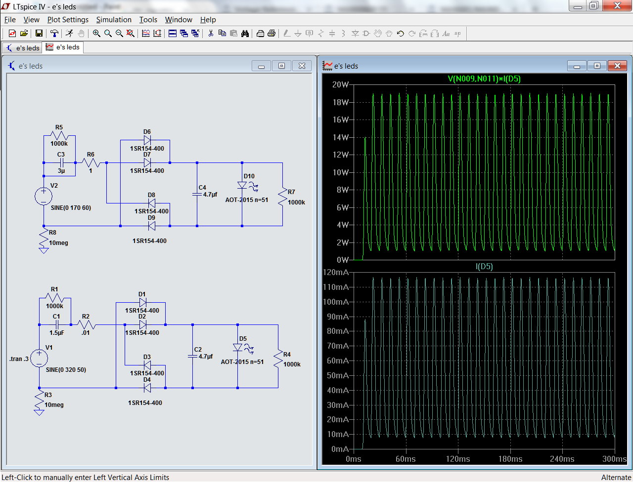

Even at 240 volts you would have been disappointed.
At 240 there is about 50 ma average per string (about right) and about 7.5 watts. So 15 watts total. That would make it kind of like a 100 watt regular bulb. A lot better, but probably not what you were expecting.:(
EDIT:
About the same as 120v & 3 Ufd.

Nice sim.
Presumably R2 & R6 represent the ESR of the capacitor, but why a value of 10 mili Ohms for the 1.5uF cap and 1 Ohm for the 3uF cap?
The individual LED diodes are characterised at 20 mA or 30 mA depending on the actual type used, which is not known, yet you say that 50 mA would be dissapointing. Why is that (genuine question)?
Out of interest, could you do a run on my second circuit to see what that would do? Why my circuits were not tried I can't understand- probably because of all the inuendo and lack of understanding. :mad:
