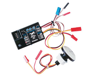

Perhaps you could try this horizon sensor that is used for model airplanes. You could mount one on the end of each boom. $50 each. See: **broken link removed**

The only problem with the 2/3 axis idea is that the ground the booms are over may not be the same as the tractor but I'm going to assume the booms are to be used in fields rather than beside tracks, in which case the coupling between the tractor and towed boom might also act as a positional guide.
The tractor end would provide the predictive section.

The only thing you should be looking at is the boom to ground distance. A axis sensor will not provide useful info. On a side hill the entire rig will be tilted but there is no need to raise or lower booms.
