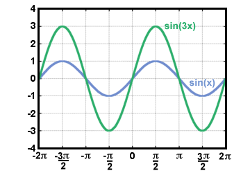

Here's a simpler, better question.
Will these two sines experience the same percentage power loss on the same wire (passed separately, not at the same time) .

but those sines in my question are voltage sines, not current sines. Still "no"?
thx
Voltage sine through a resistor AND a resistive load makes a current sine. If your load is not resistive something else...well, then things are different.

When did I say same current? I did say same power, but I don't remember ever saying same current. Are you talking about the graphs in post #21?
If those are voltage graphs, and you muck around with the load so the resulting currents are the same, then yes the absolute value of the skin losses will be the same because the currents will have identical waveforms (same magnitudes and same frequency). But mucking around with it will probably the total power delivered to the load to be different which would mess up your question of proportional losses. That's why it tends to be difficult to answer your question. By asking for proportional losses and not specifying the load, you frame your question in strange scenarios that tend to produce unfair comparisons.
The straightforward thing to ask would just be how much actual power is dissipated in the same wire with X current waveform vs Y current waveform. By asking about proportional losses you introduce a load which affects everything and makes it difficult to have a fair comparison between two different waveforms.
