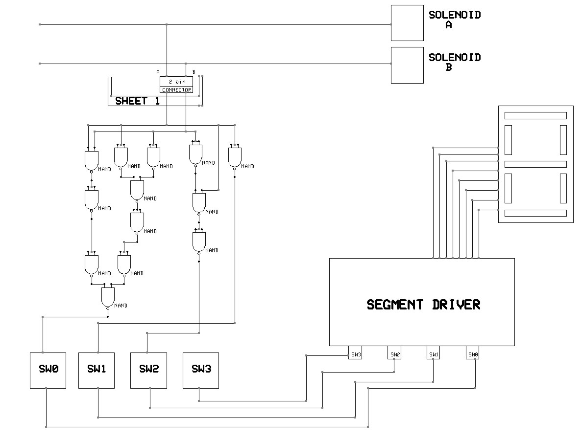

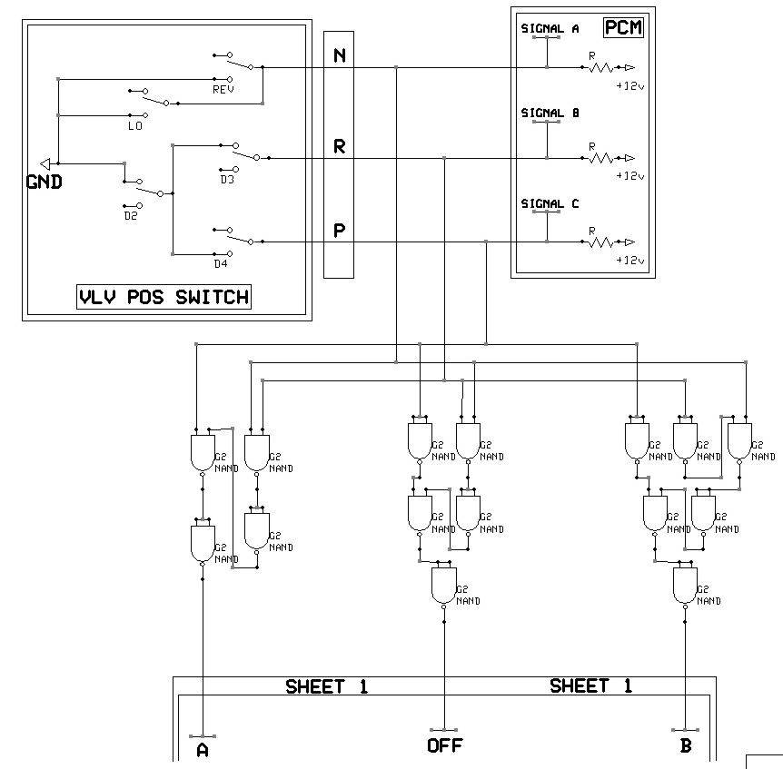

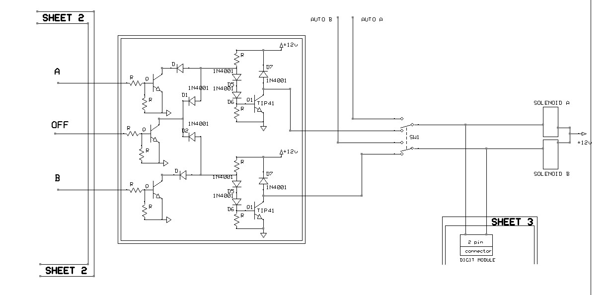

Update
ok...the 3 attached schematic pics may help...sorry it took a while but I have been getting eaten alive at work recently.
Page 1: is the core of the schematic. At the top grounds coming from the computer go directly to the solenoids for normal operation. (The switch in the diagram is actually a capacitive switch controlled relay) When switched the grounds are supposed to come from the TIP's
Page 2: This is the core base logic for decoding the hydraulic switch signals into the appropriate combinations in manual. In reality there are no nand gates...just a single 4028 to do this.
Page 3: This again is the logic for decoding the solenoid combinations to display either 1, 2, 3 or 4. Again there are no nand gates...a single 4028 decodes and through a few diodes supplies the appropriate logic to the 4511 7 seg driver.
So, as it sits right now in automatic it works flawlessly displays 1 through 4 with no problem. The issue only occurs when its switched to manual and the TIP's provide the grounds rather than the computer. The digit "3" is always displayed meaning both solenoids are off (no ground provided) even though it shifts into the appropriate gear. When digit logic voltage is checked in manual it only drops about 2.5 volts or so...the 4028 still see's "high" and the digit never changes. If I add a hard ground to the solenoid wiring the digit goes without a problem...WHAT GIVES!!!! Any help appreciated!!!!!
***Edit: the resistor values are all 4.7K and transistors to the left of TIP's are 2n2222's***

swap the tip41's for fat N channel mosfets. I suspect that the saturation voltage of the transistors may be seen as a logic 1. A fat FET will have an on resistance of a few milliohms, virtually no volts on the drains.
The TIP41's need more base drive. They will have Vce(sat)~100mV if you provide Ib=Ic/10. Change the base pullup resistors to 220 ohms, 1 Watt. Or use MOSFETs, as spuffock suggested.
Thanks for the help! Can anyone suggest a MOSFET that would work for my application? Ive never used one before...in the mean time I will try the base resistor swap suggested by Roff. THANKS AGAIN!!!
