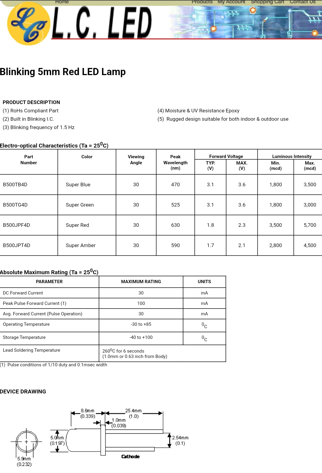

I got the flashing LEDs and piezo beeper I posted in post #8 (I had to order other parts), and tested the circuit I showed. The results are surprising.
First, I couldn't find any authoritative documentation whether these flashing LEDs need a current limiting resistor. I tested current draw vs voutage. Current draw went up to around 35mA at about 6 volts and remained constant at increasing voltage. Current appears to be internally limited, so no current-limiting resistor is required as it is with conventional LEDs.
The beeper produces ear-shattering noise at as little as 1 volt, with 1 mA current draw.
So what happens when you connect them is series? Disappointment. Apparently the beeper draws so little current that the LED "brain" can't turn on. The beeper sounded continuously and the LED did not illuminate.
Obviously they don't, because they aren't an 'LED', they are an electronic flasher circuit incorporating an LED for it's output, so all the electronics required are in the LED casing, including current regulation.
Not to disagree, but please explain how that is an obvious conclusion based on this or any other flashing LED datasheet.
On this datasheet, it lists Vf and max current, exactly as would be listed for any LED.
Those specs are presumably for the internal LED, not the external interface. None of the specs even mention the blinking part, although it's mentioned briefly above the LED spec in (2).
Perhaps you would care to post a cheap circuit for producing a fixed speed flashing LED where brightness is controlled by an external resistor?.

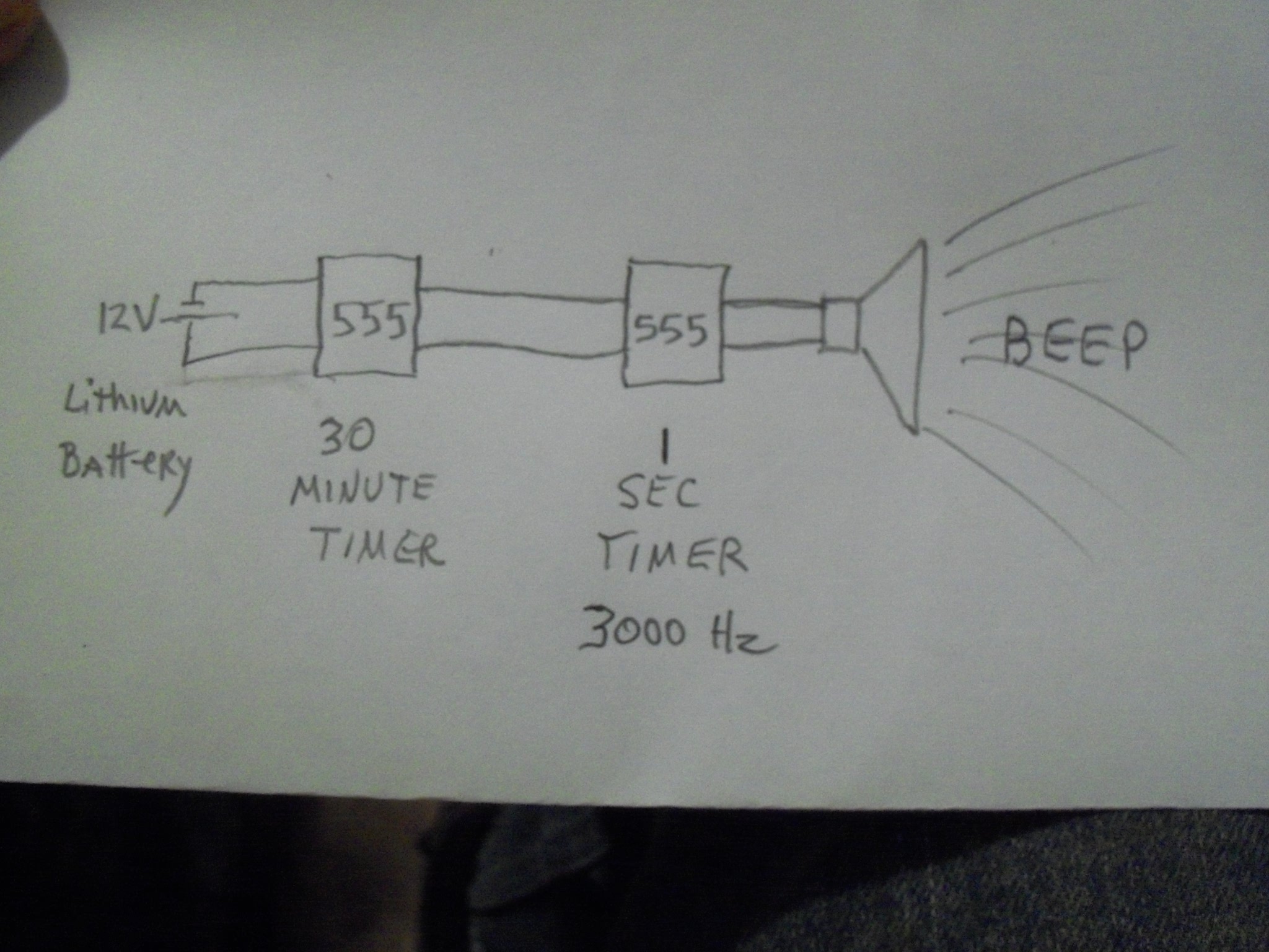

Transducer & piezo buzzer both need an osc., they are not loud enough to do what I want.
I have been experiment and this is the circuit I need. The 30 minute 555 timer turns the other 555 time ON/OFF for 1 second every 30 minutes. The other 555 times produces a 1 second BEEP at about 2.5 to 3 KHz. I have a small TV speaker 12v produces a very loud BEEP. Hide this under the living room sofa wife will jump straight up when it blasts out a loud 1 sec BEEP. Next week is Thanksgiving there will be several people in the living room. LOL. One loud BEEP will make every one jump then 30 minutes later they won't be expecting another, BEEP. LOL. Test I did the tiny TV speaker is louder than I expected.
The seller of the blinking LED says it has a built in blinking IC that operates at 1.5Hz.
The forward voltage and brightness of the LED are listed but not the supply voltage for the IC inside the LED.
The maximum current and maximum operating temperature are listed so I think the constant current parts in the IC must be limited to 30mA and 85 degrees C with an external resistor.
An old NE555 or old LM555 eat battery current all the time, even when the timer is simply timing and not powering anything.
Modern Cmos 555 ICs draw almost no battery current when timing but cannot drive enough current into the beeper so a transistor or Mosfet must be driving the beeper.
Have you ever seen a flashing LED chat has an external resistor? - I'd also like to see what kind of circuit you think would create a fixed speed flashing LED with current set by an external resistor?.

It's rather bizarre though how there seems to be no mention in the datasheets of their operation?, best I could find on a quick google was:
Flashing LEDs look like ordinary LEDs but they contain an IC (integrated circuit)as well as the LED itself. The IC flashes the LED at a low frequency, for example 3Hz (3 flashes per second).Flashing LEDs are designed to be connected directly to a particular supply voltage such as 5V or 12V without a series resistor.
