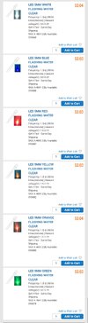

I would suggest the following parts, available from Tayda Electronics.
Start with a red or orange flashing LED - Vf is ~ 2 volts, 20mA max. Flash rate is 1.5Hz.
This piezo beeper works from as little as 1.5 volts, 10 mA max.
You may need to use three Dollar Store batteries....you're still a bit short with 2 batteries.
I'm not sure if flashing LEDs are internally current limited, so a series resistor may be needed.

A red or orange LED can be used as a warning. Therefore some are made to be flashing. A blue LED is never used as a warning therefor none are made to be flashing.
Depending on the type of buzzer or beeper, the LED will need a series or parallel current-limiting resistor.
Do you just make this stuff up? Blue, white, red, orange, yellow and green flashing LEDs are common as fly poop.
I don't buy cheap junk ($0.03 for an LED) from a "seller" on ebay, AliExpress or Amazon.
That doesn't change the FACT that your declaration is wrong.
Also, for the record, I have purchased many parts from Tayda Electronics. All as described and high quality. Except for one order of terminal blocks where their definition of "vertical" vs "horizontal" didn't match mine, and the promptly sent the correct parts.
Yeah, I suppose Chinese sellers won't take a check (cheque?) to purchase parts.
