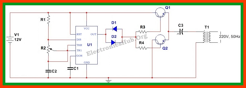

doubt using transformer
555ic
V1 = 12V
R1 = 10k
R2 = 150K
R3 = 10 Ohms
R4 = 10 Ohms
Q1 = TIP41
Q2 = TIP42
D1 = D2 = 1N4007
C3 = 2200uf
T1 = 13-0-13 transformer...
is there any problem using this volt transformer with these components?
You should probably draw a circuit so we can see what you are doing.
Welcome to ETO!
Without knowing more transformer details (primary winding resistance, inductance and VA rating) we don't know how big a problem you may have :(.
A poor circuit. D1 and D2 do nothing useful. The current gain of Q1 and Q2 could be as low as 15 (per spec), so you may not get enough base drive from a 555. The transistor saturation voltage is ~1.5V, so both Q1 and Q2 will be wasting a lot of power.

Why do you want this lousy circuit that has square wave output with no voltage regulation and no overload protection? Many modern products rely on the higher peak voltage of a sine wave and do not work from a square wave.
Yes there is. To make that circuit work you would need a 4 - 5 volt AC transformer not the one you have.
Yes some countries have a lot of problems with electric that's one reason why they ask so much and it's hard for them to buy something.
For this particular circuit i would suggest using it for low power only. Maybe 10 watts, maybe a little higher.
There more to a good inverter/converter circuit then it might seem at first. There are a lot of things going on that need addressing very specifically to get it to work right, as well as not blow up.
