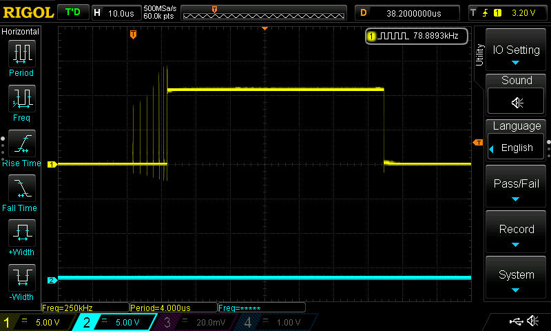

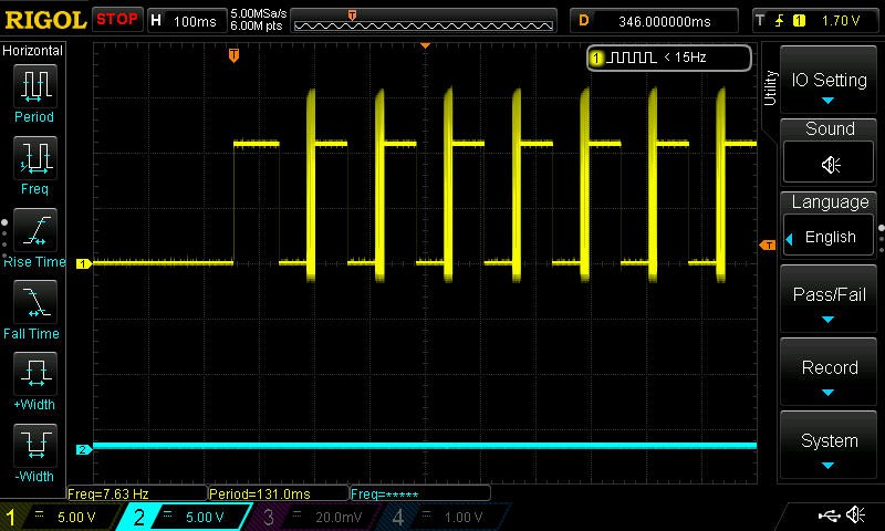

I decided the check the 555 output. On the scope you can see some strange oscillations every low to high transition, it gets worse at lower frequencies. Is this normal behavior? I thought a 555 would give clean square wave output?
I assume this is a separate question from the transistor never turning off...
Is it actually worse? Or are you just reading on a different time scale in each graph? Is the frequency of the ringing about the same between both except for the lower frequency it lasts a lot longer?
Because that doesn't look like ringing to me. It looks more like your 555 can't decide between thresholds or something like that.
Exactly what kind of 555 timer are you using?
At lower frequencies there are more oscillations before the pulse settles to high.

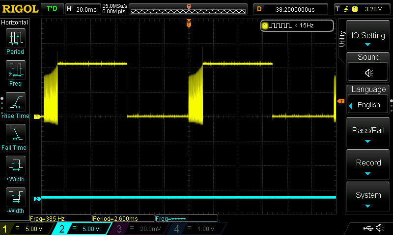

After startup the very first single pulse is clean, after that the oscillations start: see picture.

I just noticed that your 555 timer is not decoupled. Add a decoupling capacitor across the power pins. You might also want to do the same for the H-bridge itself.
If those don't work, then add a low value resistor (100 ohms or less, maybe even 10) in series with the gate of Q9. I feel like they should not be required though and your problem is something else.
