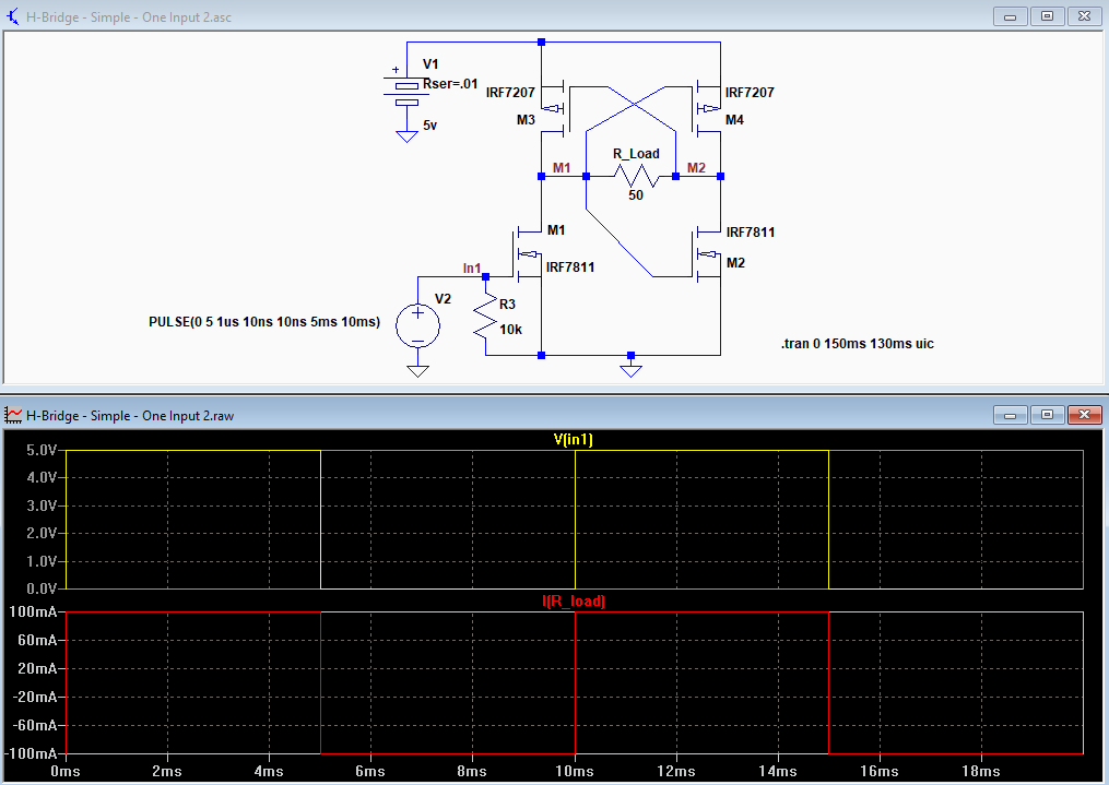

The L298 is a BJT device that has nearly a 2V load drop when on, so will not work well with a 5V supply.
Here's a simple MOSFET H-bridge that should do what you want.
It uses P-MOSFETs on the high side to simplify the gate drive requirements.
You can use other MOSFET part types, but they must be logic-level devices with a max threshold Vgs(th) of 2V or less.

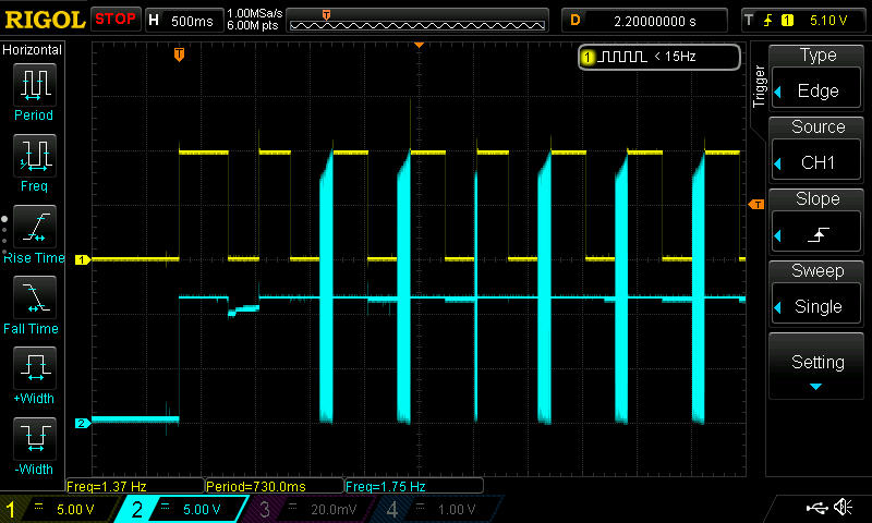

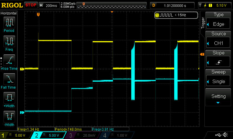

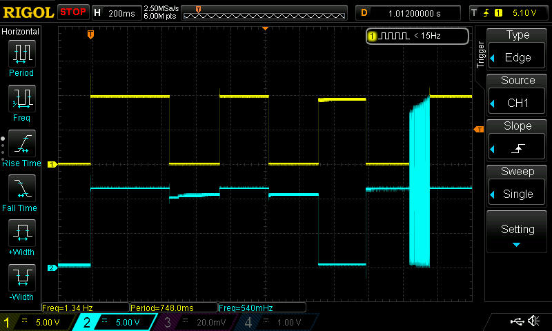

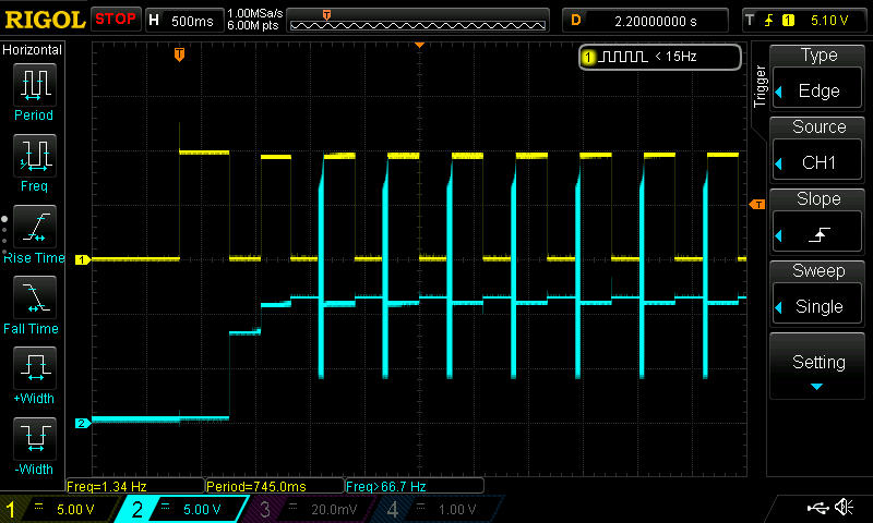

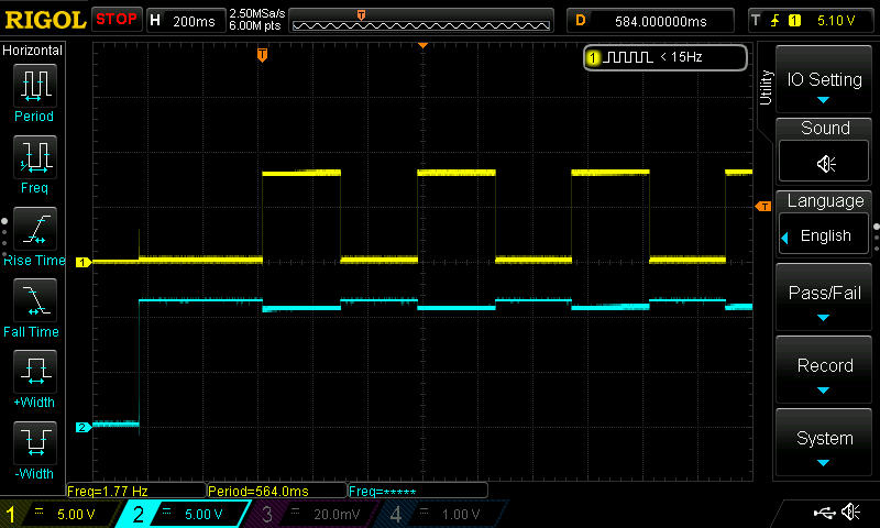

hi crutschow, I used your schematic in a pcb design (see attachment). When this circuit is built on breadboard, it works fine: it oscillates the 4 MOSFET's as it should do. When I built the same oscillator per the schematic, the H-bridge does not oscilate.
I built just the parts needed for the oscillator (555 and its components, and the H-bridge mosfets and required resistors and load.
What happens is that on startup the H-bridge makes one pulse and then stops. Using your designations for the circuit your show above (M1, M2, M3 and M4) I measure on the gate of M1 of course the 555 pulses.
The drain of M1 starts low then stays high, drains of M4 and M2 (and gate of M3) start high then stay low.
In the schematic, M1 = Q7, M3 = Q6, M4 = Q10, M2 = Q11
So this H-bridge starts off good, but after one puls stays locked. Can you please give a pointer?
Thank you,
Erik
I added pull down 10k between Q7 and Q11 gate and source: now D5 and D7 start pulsating lighting. Q11 still gets very hot.
All Mosfet's replaced, still the same.
In annex, scope output: yellow = 555 output, image taken right at start-up, blue = joint drain Q6, Q7 (M1, M3 in crutschow drawing).
Second annex: yellow = 555 output, image taken right at start-up, blue = joint drain Q11, Q10 (M2, M4 in crutschow drawing).
Both same time and voltage scale.
Annex 3 and 4: same as above, but expanded timescale.

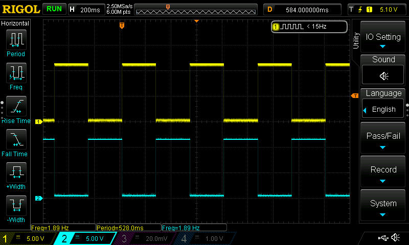

And this is measured across the load, yellow = jont drain Q6, Q7
blue the other side (joint drain Q10 Q11)
Edit: I placed a 100nF from pin 5 to ground
Do you have decoupling capacitors directly from the bridge voltage to ground, such as a 0.1μF ceramic in parallel with a 10μf electrolytic?
Is there a short ground connection between the bridge ground and the 555 ground?
There was not, but now there are: 47uF and 100nF ceramic, next to the 555 and the bridge
There is a ground backplane on the pcb, and 555 is about 1cm from the bridge
Scope in annex, view across the load: yellow = joint drain Q6, Q7, blue = joint drain Q10, q11
At least now the bridge first conducts one way, then next the other. But that is it.

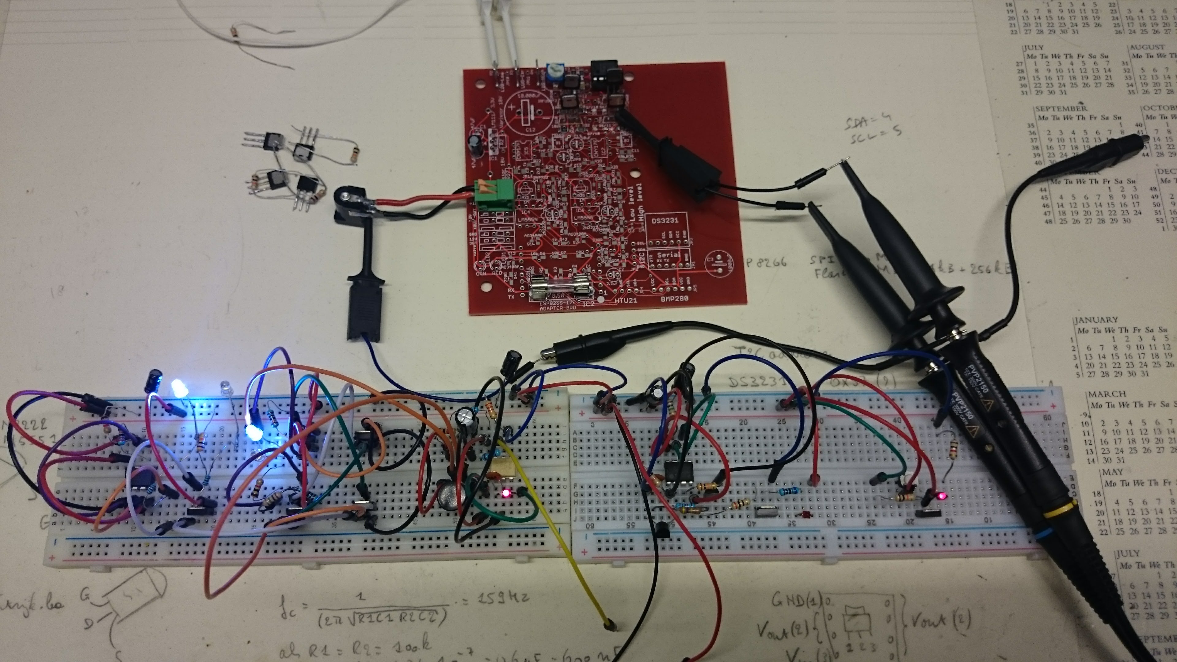

EDIT: the stupid breadboard circuit works, every time I switch it on. I am sure if it could it would be laughing :banghead:
EDIT2: breadboard versus pcb :arghh:
With a 10k resistor across drain-gate of Q11 (M2 for crutschow) the lower part of the load starts to oscillate (yellow = joint drain Q6, Q7: oscillates; blue = joint drain Q10, Q11, stays high).
Now what to do to get the blue section to switch on and off?

This design is junk.
Impossible to get the inverted signal to work properly from the drain of M1. Only solution is to invert the incoming square wave (gate Q7) with an external inverter (in my solution using a p-channel with gate to signal and drain connected to gate of M2 and 10k load to ground) and apply that to the gate of Q11.
The reason it worked on a breadboard is due to stray capacitances and impedances. On a properly designed pcb with short leads and proper ground as is the case here its flaw appears: timing contradictions between both bridge leg drivers.
