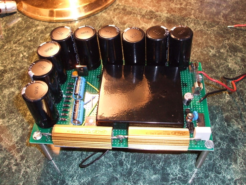

I have built a capacitive discharge system for my electronic firing system and I have (9) 200vdc 220uf capacitors that charge up from the power supply.
I am needing to use a resister to slowly drain the capacitors once power is turned off. I am using Dale aluminum RH-560 50W 1.5 ohm on my power supply to generate the 200vdc power load.
I would like to use (1) resister to slowly drain all (9) separate power lines, these are individual power lines but I would like to slowly drain all of them with one resister.
What do you recommend, and do you have a diagram that can be put to use?

The caps probably won't care about discharge rate. Old rounded-off screwdrivers used to do the trick real well, although they would occasionally weld onto terminals. If you want to use a switch and have it last, grab a 10 watt 1000 ohm sand resistor and switch it across the caps. Just leave it connected for 10 minutes and all charge will be gone.

Since these caps are not in parallel and are totally separate; connect a resistor of sufficient value and wattage across each capacitor. This is called a bleeder resistor. It's value depends on the voltage across the cap and how long you are willing to wait for it to discharge to a safe level.

You are right they are not in parallel and are totally separate, would I have to use a large 35W aluminum resistor to accomplish this, my power supply is at 200vdc and I am using 220uf caps.
Bleeder resistor is what I am looking for and the discharge time is not relevant as long as it does discharge slowly.
I would use a 1/2watt 150K:eek:hm: resistor across each cap in a trade off between wasted power, heat, discharge time, and cost. Should take about a minute for the caps to discharge to a safe level.

Why bleeds the capacitors and drain energy while the system is in standby/use? Fits a 24V relay at the supply side to switch OFF the bleeding resistor when 24V supply is healthy.
If all the 9 capacitors have a common negative connection, then it might be possible to connect up all positive terminal of the capacitors to a common point using blocking diodes and discharge all 9 capacitors with a single resistor.
Use some 250V mosfets with bleed resistors in drain. One button press (tied to all the gates) could turn them all on and discharge each C with its own resistor. BTW, you do not need high watt ratings for the discharge resistors in this case because they are not always in circuit dissipating power. They only switch in when you signal to discharge.

So typically using the 9 blocking diodes to prevent backflow from the 9 Capacitors I can connect all 9 capacitors to a block and using a single switch to discharge all 9 capacitors into a single resistor.
So, if I switched all 9 capacitors into a single resistor, I would have 9 200vdc 220uf caps. Would one Dale RH-50 50watt 1.5k aluminum resistor handle that kind of power to drain?
If that were the case I could add a swich, possibly a high power SCR, or Darlington Pair or a relay to a toggle and add an LED and discharge.

Yes, if the capacitors all have common negative connection.
This is how I estimate the wattage of the resistor, for a one off, infrequent discharge operation. The initial wattage is calculated as usual, using the V*V/R formula, giving 26W for a 1.5K resistor. However, as the discharge current is not constant but reducing quickly, it is possible to select a smaller wattage resistor in this case. I would go for a 20W or 15W aluminum resistor in this case.
