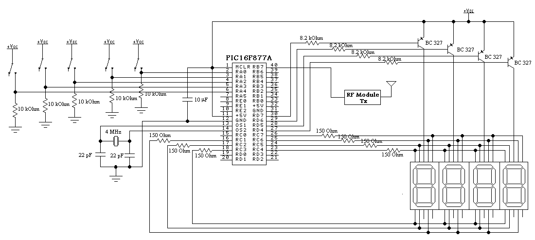

Mike said:
I'd like to see the schematic of the hardware that goes with that code.
Yes, here it is. BTW, do you understand what I said? My problem.
Your schematic looks ok.
I'm afraid I don't understand what you're trying to do. Is that code example complete? I don't see where you're driving the displays and several other subroutines seem to be missing. What are you displaying, hours and minutes?

Does anyone know how to increase the brightness of the multiplexed 7-segment displays? Can I ignore the collector resistor since there is already base transistor to control the current flow through the collector.
I have almost done my PCB and found that there are 2 extra IO pins. If I need a ground and don't want to route for so long, can I just use the extra pins to make ground (0)?
No, you can't ignore the current limiting resistors - the base resistor is nothing to do with it, that's to limit the current from the PIC to the base - the transistors are used as switches, not amplifiers.
If you want to increase the brightness use PNP transistors to feed the segments, with lower value current limiting resistors (modifying the program accordingly). Currently the brightness is limited by what current the PIC can provide.
Yes I'm using the PNP transistors.
I thought the collector resistor is to limit the Ic max? As long as the Ic is below Ic max, Ic is controlled by the base current isn't it?
