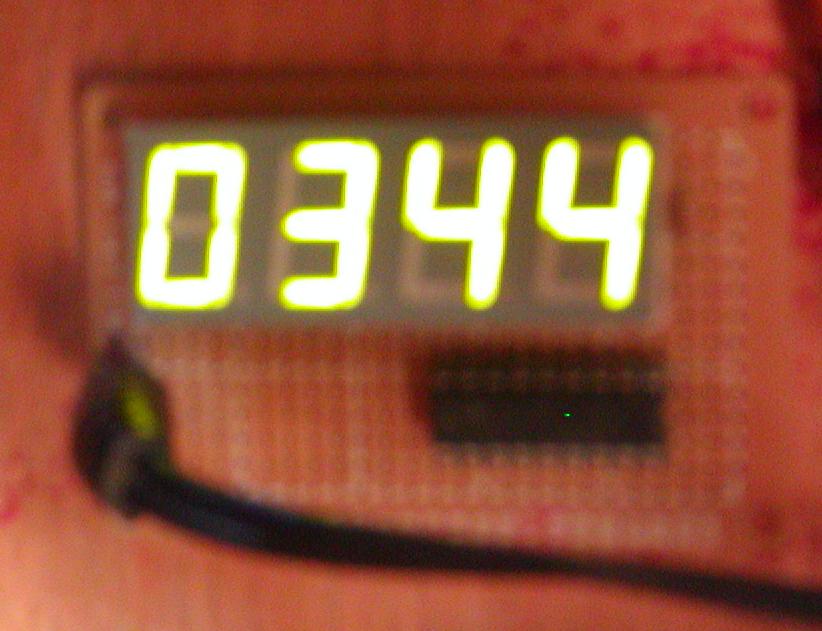

Here's a very fuzzy picture of a 4-digit common cathode stick display. The common cathodes have transistor drivers and the segments (anodes) are directly driven. This board is actually using the Charlieplexing type of multiplexing where 8 pins are used to drive the columns (common cathode transistors) and the segments (anodes) instead of 12 pins. It's quite a bit dimmer than a full brightness display. It throws off plenty of light but you can't see it very well in a sunlit room and you can't see it at all when it's in direct sunlight.
