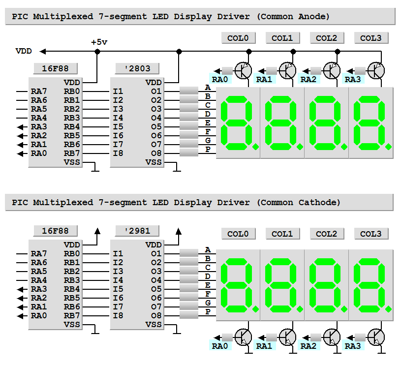

I thought the collector resistor is to limit the Ic max? As long as the Ic is below Ic max, Ic is controlled by the base current isn't it?
Only if you're using the transistor as an amplifier and not a switch - add NPN's and lower the resistors - all removing the resistors would do is strain the PIC.
You could also use a ULN2003 (or ULN2803) sinking driver IC instead of seven NPN transistors.
Why is it needed? Direct from the output pin to the base via a resistor will do right?
I was supplementing Nigel's suggestion of using NPN segment driver transistors to improve overall display brightness.
Use PNP as 7-segment display selection and NPN for the patterns right?
I think I will just reduce the resistance of the collector, because the PCB space is limited.

But the PIC hasn't got enough current capability - which is why the resistors are there! - check the PIC datasheet, maximum current per pin, and maximum total current.

The datasheet of ULN2003 shows that there is a 2.7 k:eek:hm: resistor at the input. So I can use it without a resistor right? And the output logic of the patterns have to be inverted.

You still need segment current limiting resistors.
A '1' on an input turns on its corresponding output which sinks current to the LED segment turning it on.
Stick with common anode displays and use the ULN2003 or ULN2803 to drive the segments.

That’s correct, a digital "High" (5V) at the input will supply an earth to the output (like a switch to earth), a logic low (0V) will turn off this earth ("open circuit") thus turning the segment/device off

How can you use the ULN2003/ULN2803 for a common anode segment? They switch earths, not supply voltages - the common +ve supply pin is purely for inductive loads (notice every output has built in diodes to protect from back EMF)
Not sure what you mean by a common anode segment but common anode displays have the anode of each segment tied together and supplied or switched at a positive voltage. The other end of each segment requires a sinking driver, like the '2003. A simple example is shown in the post just previous to your last post. You connect the ULN2003 diode connection to the same positive supply that you're using for the common anodes.
I assumed you were describing using a ULN2003 as a sinking driver for a multiplexed common cathode display, using it to replace the sinking NPN drivers in the "common cathode" drawing below. Yes, no?
Oh god, you're correct. I'm muddled, the resistors are needed, they are the load of the collector.

He meant using both PNP and the ULN2003. PNP to supply the common anode while ULN2003 used for the patterns of the 7-segment display.

That would be complete overkill wouldnt it? Just use the ULN2003 to switch the common cathode for each display - the pic can drive each segment easily, but a resistor for each would still be required to limit the current for each segment.

Because previously I complained that the 7-segment display is not bright enough. If I use common cathode, the current sourced by the PIC is enough?

Yes, I agree, it is "overkill" but it provides you with a full brightness display. If it takes 10-ma per segment at 100% duty cycle for full brightness you're going to need 40-ma per segment pulses at 25% duty cycle for full brightness (and a source driver capable of 40-ma for 7 or 8 segments = 280..320-ma). Driving the segments directly from the PIC pins as you suggest just isn't going to cut it if you need full brightness. Sorry.
