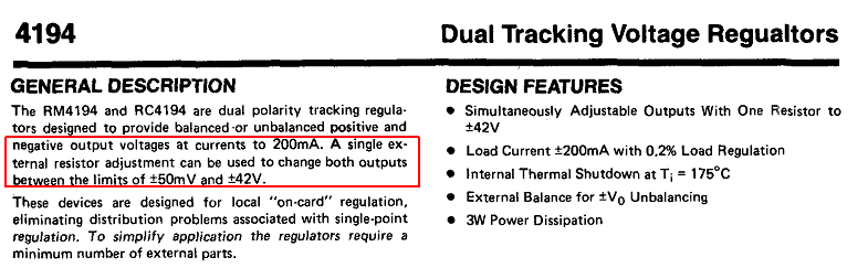

Probably your most difficult requirement is the 0V minimum. Your monolithic regulators tend to have a reference around 1.2V.
The RC4194 can go down to 50mV Vout.
I wouldn't recommend using for a new project, because of the availability.
It was a 'nice' device, especially the dual tracking feature.
