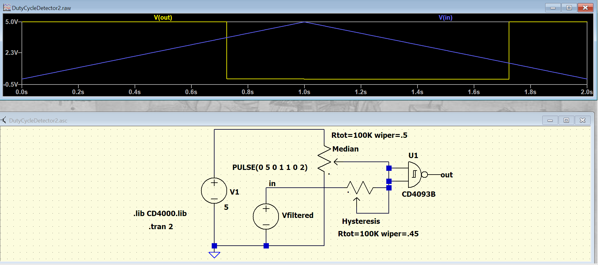

If you were thinking of using a CD4093 (or other Schmitt gate) as a buffer anyway, it would be a simple matter to use another gate in the same package to do the thresholding/comparison function too, like this :-
How much hysteresis do you actually need?
Hysteresis: not much, about 5% or so, just to avoid jitter.

If your output is 0V/5V then at 100% the voltage at "RC" will be very close to 5 volts. The voltage comparitors input will be in the 2.5V to 4.8V range. Most voltage comparitors will not work when both inputs are too close to the VCC supply. With a 5V supply the input will only work from -0.4 to + 3.5V. (It is OK to have one input at 3.5V and the other at 5V) Some SPICE components do not work like real parts.
Two fixes:
1) Invert the signal so 100% = 0V and 0%=5V. Then the "RC" voltage be below 2.5V for 100% through 50%.
2) Add a resistor across C2 to pull down the voltage. (voltage divider) Set the max voltage to no more than 3.5V.
About 5%, just enough to avoid jitter.
