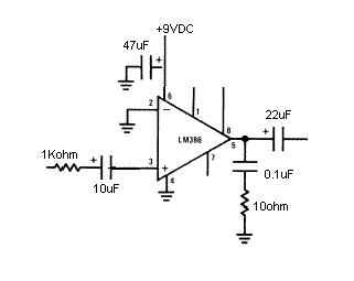

I tried out building a new circuit around the LM386, which I found at the RadioShack, since everyone pretty much agreed an op-amp would work out better. I checked out it's , to come up with my circuit. The 20x gain the LM386 defaults to is reasonable, but I think I'll modify it with a rheostat to tweak it at will. I have two questions that strike me immediately. First, the input 10uF cap is electrolytic, and the second page referenced shows it with the positive towards the input. Looking at the internal schematics LM386, this seems acceptable since that side goes to ground. Is that acceptable? Secondly, what's the function of the 0.1uF cap and 100 ohm resistor to ground on the output? The original spec was for a 0.05uF cap, but I substituted it for 0.1uF which I had on hand. I'm guessing this circuit acts as some sort of filter to lessen noise. Is this the case, and is my substitution acceptable?
In response to the discussion of impedance coupling, for microphones, at least, wouldn't having matched impedance create a load on the mic itself, thus causing distorted input?
TJ
It isn't an opamp. It is a power amp. It is pretty noisy if it has a gain more than 20.
The input DC voltage of the LM386 is 0V so if the capacitor is fed from a grounded volume control then it doesn't matter which way the capacitor's polarity faces.
At first I thought 10uF is way too high a value. Then I realized that it would help reduce noise if the volume control is 1k to 10k ohms.
It is 0.05uF and 10 ohms. 0.1uF might work but I would use 0.047uF instead. It stops the LM386 from oscillating at a high frequency when the inductance of a speaker causes a high load resistance, like your application without a speaker.
A matched impedance doesn't cause distortion, it causes the output to be half.
