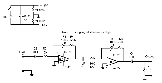

Ok, after looking at several different hobby websites and whatnot, as well as raiding the local RadioShack once more, I came up with a TL082 (Yay! :p ). I want to make a two stage amp from this with volume trimmer. The only thing I could dig up that I could fit easily was a 100K :eek:hm: stereo trimmer, R3. Since it's got two pots ganged together, I figured I could wire them both into both TL082 stages' negative feedback. I don't know if it is acceptable to control both stages' gain at the same time, or if I should only adjust a single stage. If I should only adjust a single stage, I'm guessing that it would be better to adjust the secondary stage. This way the primary stage would output a constant gain at low noise to ensure a strong clean signal for the secondary, correct?
I drew out and attached my design. Any obvious flaws? I was unsure of how to couple the two, so I borrowed this idea from a hobby site. I have a 1uF tantalum capacitor, C3, and a 10K :eek:hm: resistor, R5. Also, in order to provide both positive and negative voltage, I used two 100K :eek:hm: resistors, R1, to provide ground so that I have + and - 4.5 Volts from a single 9V battery. I'm unsure if this is sufficient voltage differential to perform my desired task. I'm guessing this sets the maximum peak to peak output possible at 9V?
Also, I found on one site the idea of sticking a 10K resistor, R7, across the output. The reason given was to provide a DC ground reference to the next circuit, since the output is decoupled. The example circuit did not have a zobel network. A zobel network doesn't look like it would provide a DC ground reference. Is it necessary to provide this ground reference? I have had previous troubles with AM reception when touching the mic, so I'm wondering if this would solve the ground problem. Also, if this is a good thing to have, should I throw in a zobel network in addition, or does this resistance provide sufficient load as well?
Lastly, the site I used as a guide to design this circuit used 10uF capacitors to decouple at both input and output, C2 and C4. In the previous designs discussed, the value for the output cap was larger. Using a reactance calculator, it seems as if either 10uF or 22uF would have much less than 1 :eek:hm: resistance at audio frequencies. This makes me think that either value would work equally well? I picked up a few tantalum 10uF capacitors I could use for C2 and C4. Would these be reasonable to use? I'm interested to know if electrolytics are better/worse, and if 10uF is acceptable.

In my experience soundcard mic inputs are awful anyway, regardless of the mic used (or any external circuit). It seems that every sound card I've used (haven't tried the really high end ones) have a poorly designed, cheap analogue input for the mic, as its generally used for voice comms (telephone quality). Even when I wacked the sampling rate up to 48Khz still lost a lot of frequency response, and that was with a relatively clean opamp circuit...gain of 20, 1Mohm input impedence, and 22kohm output impedence.
If you are recording high quality audio (16bit+ 48Khz+) then the only real solution would be to use the 'line in'. It'll need an amplifier/buffer for the mics tiny signal but the quality is far superior.
However, if this is simply for voice comms (internet games, MSN etc..) then that circuit looks fine to me, although I haven't tried it. Beware though, the voltage on the mic socket, for the bias on my soundcard is 3V, thats just not enough for a decent preamp, you'll want more headroom, an amp powered by 9v would do nicely. here's some links:

After reading some more, I'm starting to think that the tantalum caps definitely require a refinement in design. I'm thinking I need to add a DC bias possibly in order to ensure they are not reversed. My other thoughts were to replace C3 and C4 with 0.1uF ceramic discs.
I'm trying to understand the selection of the values for DC blocking caps. The primary criterion is reactance across audio frequencies, correct? Well, the inputs to the first and second stages are both 10K:eek:hm: by R2 and R5. 0.1uF is 5:eek:hm: at 30 Hz, and much less than one at 30,000 Hz. This is magnitudes smaller than 10K:eek:hm:, so I'm thinking that there would be no significant difference if I simply used 0.1uF caps. For the output, I think the output impedance of the TL082 is low, less than 100:eek:hm:, correct? In this case, perhaps the reactance at low frequencies would be more of a problem?
Tantalum caps cause severe distortion when used for coupling audio, and they are not reliable. Ceramic caps also cause distortion and are "microphonic" so are not used for coupling audio but are OK for toys. Film caps are perfect. Electrolytic, even bi-polar electrolytic aren't too bad for coupling audio.
The reactance of a capacitor is less at high frequencies and can be ignored.
When the reactance equals the source impedance and next impedance added, then the response is down 3dB which is 0.707 times the voltage which sounds a little low.
For each of your coupling caps, the load is 10k. So if the reactance of each cap equals 10k at the lowest frequency you want then their responses all add to a drop of 9dB which is too far down at nearly 1/10th.
If you want the lowest level frequency to be 100Hz, then calculate caps with a reactance of the 10k load resistance but at 10Hz. Then when their slight drops at 100Hz add, the response will be correct.
A cap of 1.6uF has a reactance of 10k at 10Hz.
