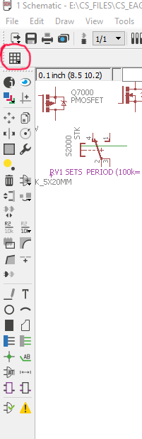

I searched myself silly trying to find out how to set the grid default in "library", ".brd" and ".sch" to 0.05 inch and the alt to 0.005 inch.
I know it must be done in eagle.scr but that is as far as I got.
Help is much appreciated!
Thks
Erik
Hy earckens,
Open the schematic and left click on the grid icon top left (circled in red) to get a drop-down menu. Then just enter the grid spacing that you want: I always use 0.05 inches rather than the default 0.1 inches. You can also turn the grid on and off from the same drop-down menu.

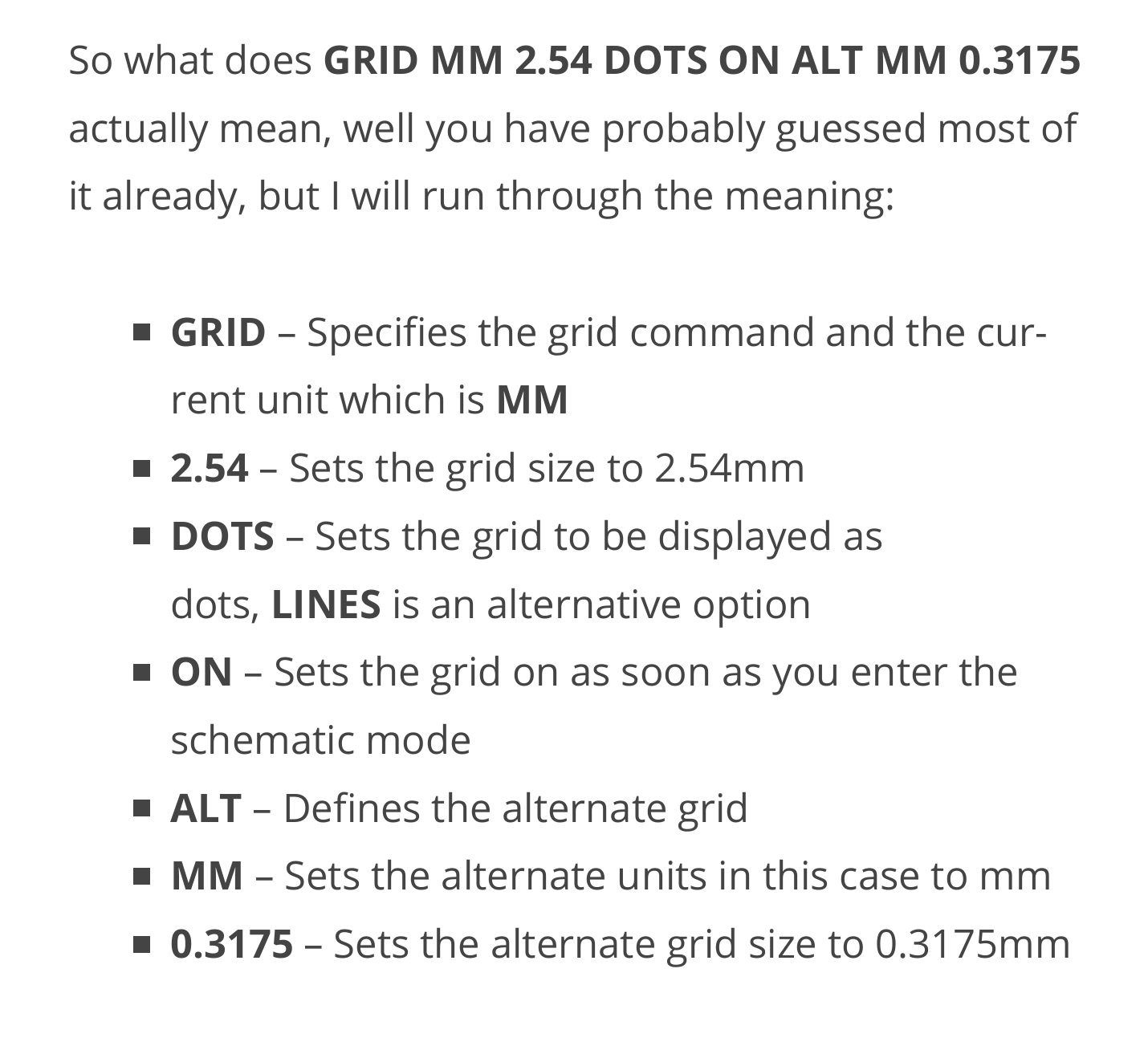

Check out this link. There is a good description of the eagle.scr file, including setting alt grid.
I need to do some housekeeping on my Eagle installation...like deleting all the libraries I don't use from the list and adding those I do.
I did find that too but I am not sure how to change my current "eagle.scr" to what I want it to do:
1. dimensions in inches
2. standard grid 0.05
3. alt grid 0.005
This for .sch, .brd., .lib
